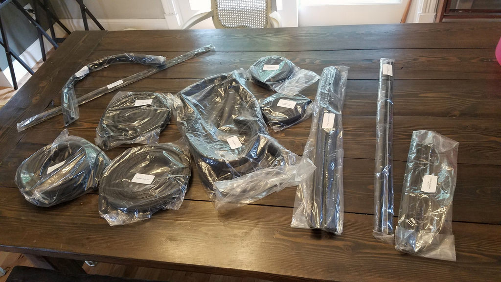

After talking with someone who's been building these engines for years, and a close friend who built one recently, they both lean toward non-oil fed tensioners, but with the safety collar. I know everyone has their own reasons, but Aaron is one of the best in the business and really, I mean really knows his stuff.
Waiting to connect with a friend that has the correct 46mm crows foot and cam holding tool so I can move forward with the tear down. In the meantime I got a nice little box from 914rubber yesterday.
(IMG:http://www.914world.com/bbs2/uploads_offsite/c1.staticflickr.com-19709-1499370655.1.jpg)
That's seals for both trunks including bulkead, and all of the door/window seals. Love it.
