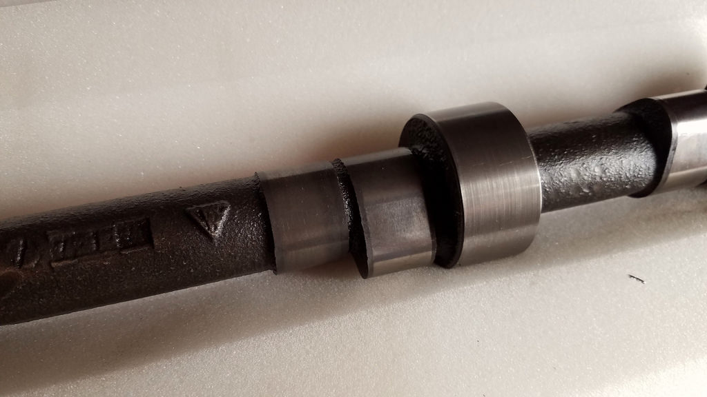

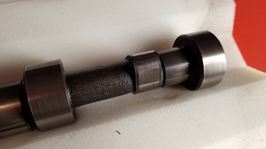

Yesterday I made the drive to a friends to pick up the specialty tools for removing the cam gears, got a little box of goodies from his engine build as well, case sealer etc.
So, now I was able to dig into the motor more (technically, I could have without the tools, but potato tomato) Started with the cyl 1-2-3 bank. pulled the rockers, cam, cam housing, heads, and cylinders.

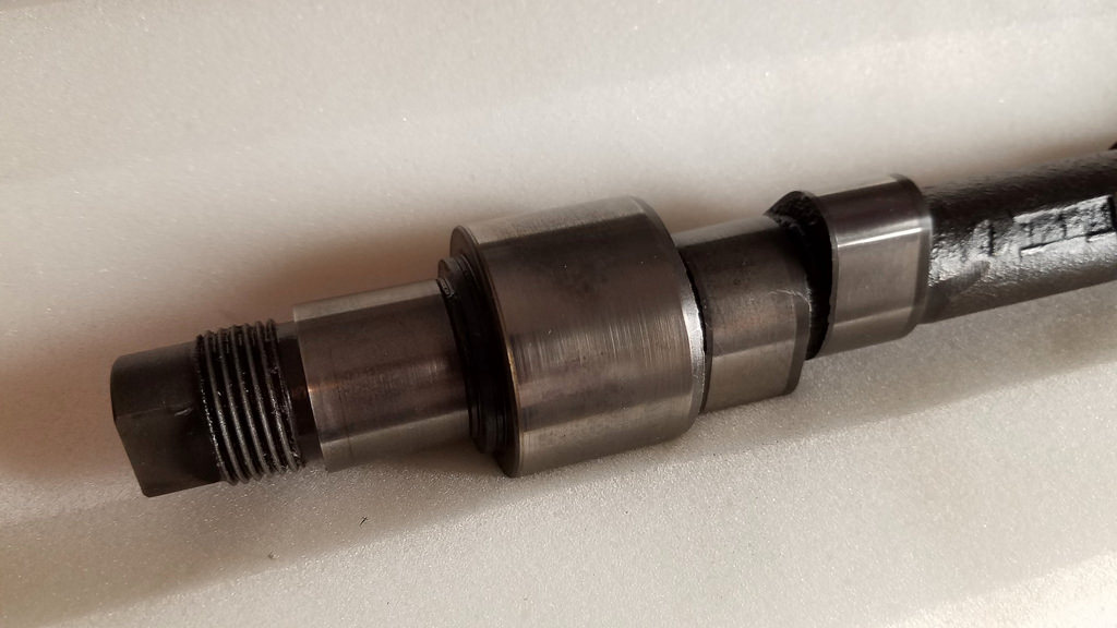

cam is 901.105.133.0R which is the stock cam for this engine (1971 911T). I'll be measuring them up to see if they've been ground at all.
cam - #3 cyl end
(IMG:http://www.914world.com/bbs2/uploads_offsite/c1.staticflickr.com-19709-1499959839.1.jpg)
cam - middle
(IMG:http://www.914world.com/bbs2/uploads_offsite/c1.staticflickr.com-19709-1499959839.2.jpg)
cam - #1 cyl end
(IMG:http://www.914world.com/bbs2/uploads_offsite/c1.staticflickr.com-19709-1499959839.3.jpg)

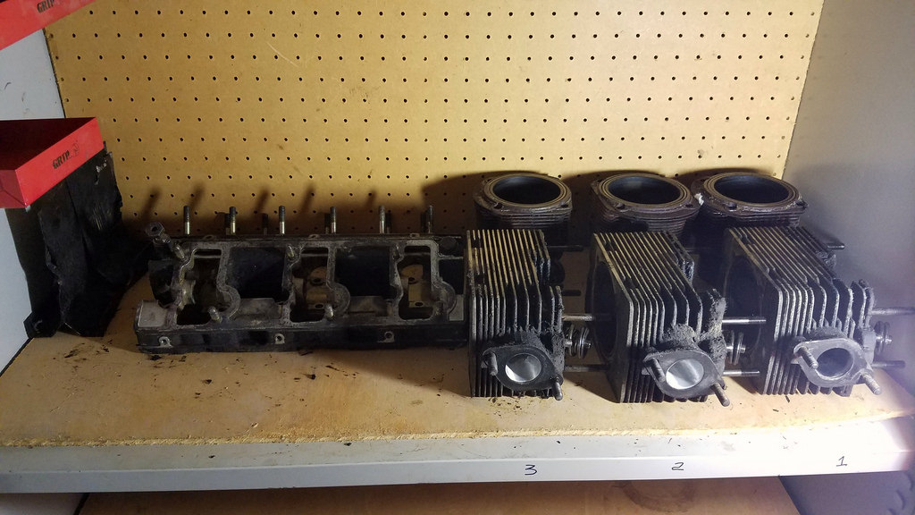

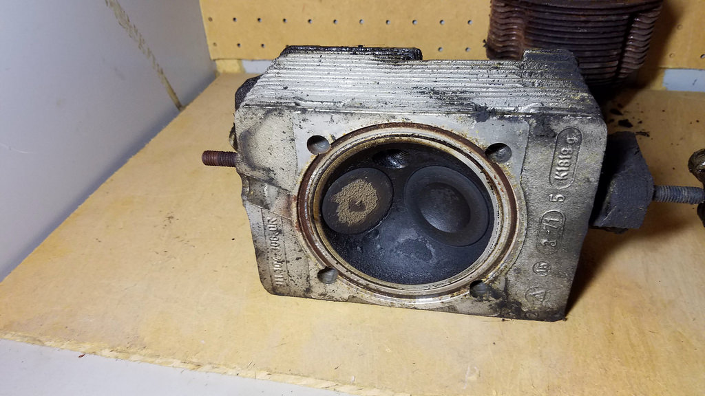

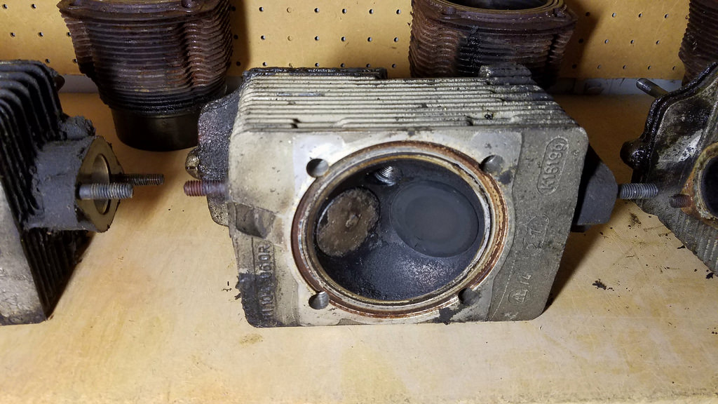

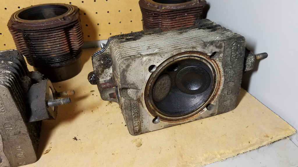

#1 head
(IMG:http://www.914world.com/bbs2/uploads_offsite/c1.staticflickr.com-19709-1499959840.4.jpg)
#2 head
(IMG:http://www.914world.com/bbs2/uploads_offsite/c1.staticflickr.com-19709-1499959840.5.jpg)
#3 head
(IMG:http://www.914world.com/bbs2/uploads_offsite/c1.staticflickr.com-19709-1499959840.6.jpg)

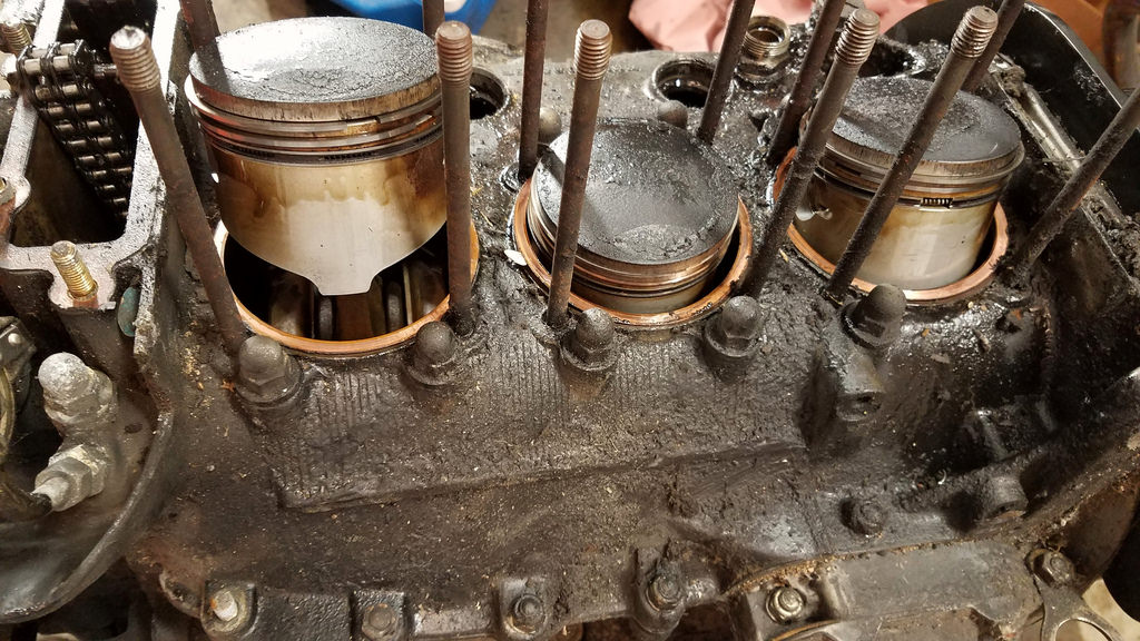

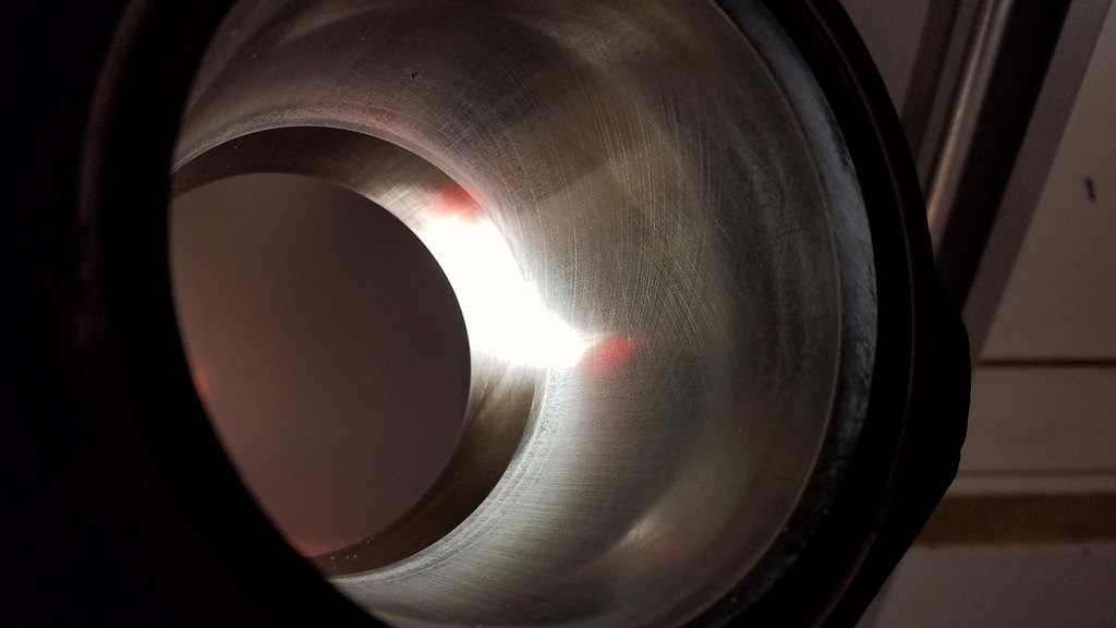

all of the cylinders looked like this
(IMG:http://www.914world.com/bbs2/uploads_offsite/c1.staticflickr.com-19709-1499959840.7.jpg)
everything is generally caked in either carbon deposits or oil/grime, but is in generally good shape.
(IMG:http://www.914world.com/bbs2/uploads_offsite/c1.staticflickr.com-19709-1499959840.8.jpg)
So, everything looks pretty good. And by pretty good I mean nothing terribly terribly borked. i.e. no valve/piston contact or broken rings. The whole thing came apart pretty easily, no complaints.
