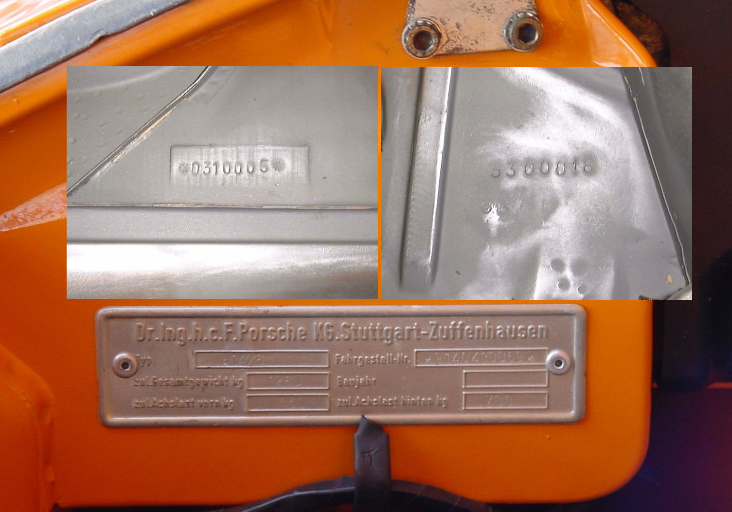

Hi all,
Last week a coworker sent me a photo of a 911 without a VIN.
Its a factory built race car that the owner bought new around 1970 (i think) and put the car away, never really drove it i guess.
To look at the photo you'd think it was a nut and bolt restoration, but its all original!
So, did Porsche actually build cars without a VIN in situations like this?
I can't help but think that they had to put some sort of numbers/ID on it.
Did they build any 914s in this same manner?
SteveAttached Image

Tom_T   Steve, Since a VIN is technically only a US-DOT ...   Jul 11 2017, 05:14 PM
74ravenna   Thanks for the explanation Tom. Never heard of ...   Jul 11 2017, 05:18 PM

gms   I believe a “body in white” was just that, a b...   Jul 11 2017, 06:44 PM
Tom_T   I believe a “body in white” was just that, a ...   Jul 11 2017, 06:55 PM
gms   I believe a “body in white” was just that, a...   Jul 13 2017, 09:24 AM
lalee914   [quote name='Tom_T' post='2505514' date='Jul 11 2...   Jul 15 2017, 08:56 AM
Tom_T   [quote name='Tom_T' post='2505514' date='Jul 11 ...   Jul 15 2017, 09:54 AM
gms   Hi Glenn, According to an e-mail I have from 2004...   Jul 15 2017, 10:39 AM
