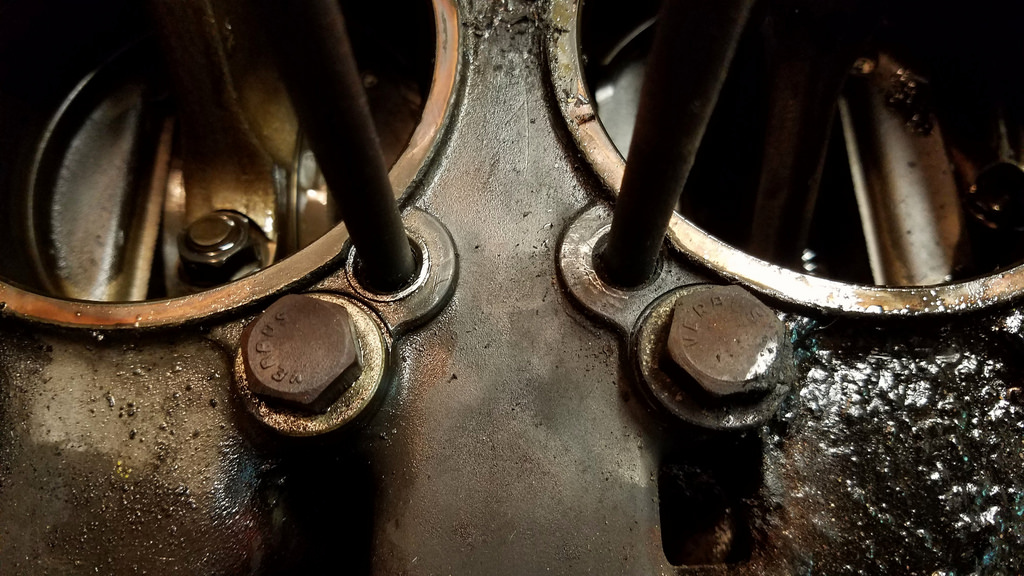

Went to inspect the head studs and found something...
(IMG:http://www.914world.com/bbs2/uploads_offsite/c1.staticflickr.com-19709-1500043051.1.jpg)
Looks like someone installed case savers already. Judging by the fact that all of the cylinders and heads came up with no issues, I'd say they're straight. The one on the left is slightly proud of the surface, where the right one is flush.
All of the studs on this case half have them, didn't even think to flip it over and check the other side, I got called away right after I took this pic.
Again, no history on this motor. Complete unknown. So it's nice to see this when I very well could have been looking at toasted valves, heads, chains, and much more.
