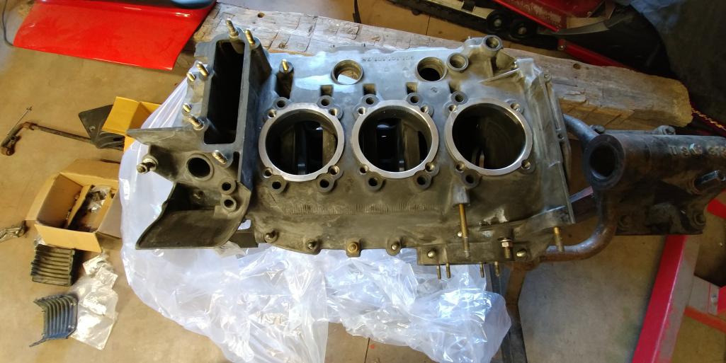

Optimusglen   Yesterday I made the drive to a friends to pick up...   Jul 13 2017, 09:30 AM
Optimusglen   Tore down a bit more. #4/5/6 pistons, cylinders, a...   Jul 14 2017, 08:37 AM

JmuRiz   Looks lucky thus far. My previously rebuilt 2.7 co...   Jul 15 2017, 07:37 AM
Optimusglen   Case split, nothing scary! http://www.914worl...   Jul 15 2017, 07:49 PM
bretth   Case split, nothing scary! Nothing scary bu...   Jul 15 2017, 10:55 PM
Optimusglen   Case split, nothing scary! Nothing scary b...   Jul 16 2017, 05:33 AM
mb911   Case split, nothing scary! Nothing scary b...   Jul 16 2017, 08:17 AM
mepstein   Case split, nothing scary! Nothing scary b...   Jul 18 2017, 01:32 PM
bretth   [quote name='bretth' post='2506818' date='Jul 16 ...   Jul 18 2017, 01:44 PM
GeorgeRud   I took the easy way and had Henry rebuild my 2.7, ...   Jul 16 2017, 08:59 AM
mb911   I took the easy way and had Henry rebuild my 2.7,...   Jul 16 2017, 10:40 AM
Optimusglen   Initial inspection and measurement taking tonight....   Jul 18 2017, 01:14 PM
Optimusglen   Good news! Crank journals are all perfectly in...   Jul 18 2017, 08:38 PM
