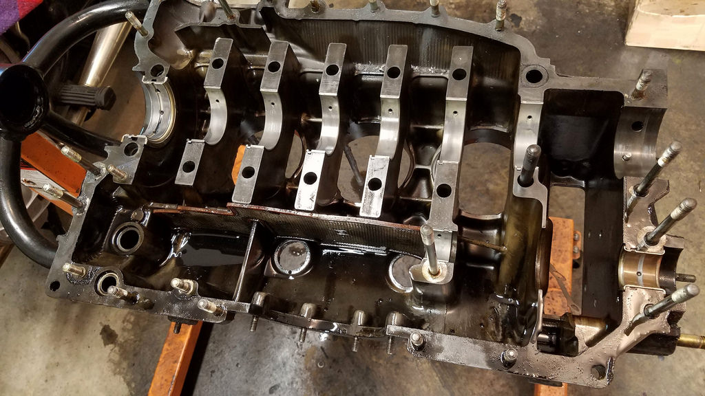

Case split, nothing scary!

QUOTE(Optimusglen @ Jul 15 2017, 09:49 PM) *
Nothing scary but minimum $2k just to make it bolt back together again. I wonder if anyone has ever been lucky enough to put a mag case back together without needing machining. Keep up the good work.

QUOTE(bretth @ Jul 15 2017, 11:55 PM) *
Nothing scary but minimum $2k just make it bolt back together again. I wonder if anyone has ever been lucky enough to put a mag case back together without needing machining. Keep up the good work.
I had read that all mag cases need machining.
