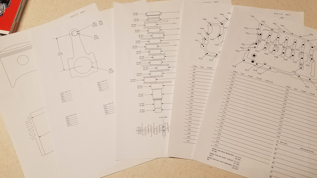

Initial inspection and measurement taking tonight. Made up a few sheets to keep track of measurements to compare them to spec. Also so I can note installed stud height, hole condition, presence of inserts, etc.
(IMG:http://www.914world.com/bbs2/uploads_offsite/c1.staticflickr.com-19709-1500405274.1.jpg)
