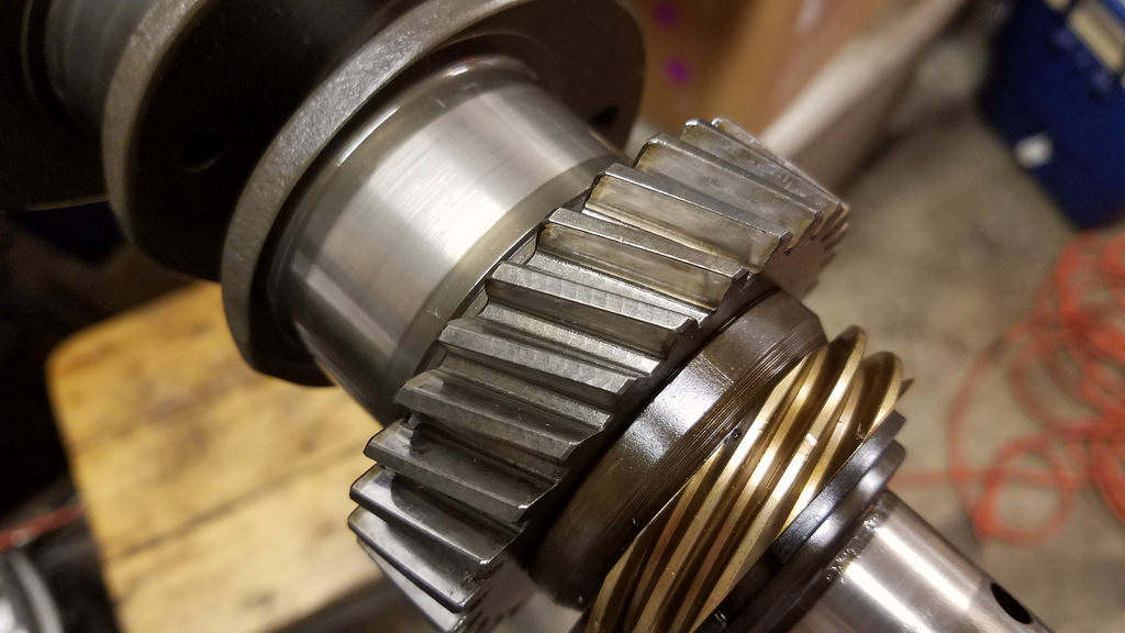

Good news! Crank journals are all perfectly in spec, almost all right down the middle.
Need to machine up an adapter to check crank runout. If that checks out then I'll find some place to inspect for cracks. Is magnaflux still the standard?
Crank to intermediate shaft gear, as well as the distributor gear. Few nicks in the soft gear, but nothing bad IMO, I'll clean it up a bit and reuse it.

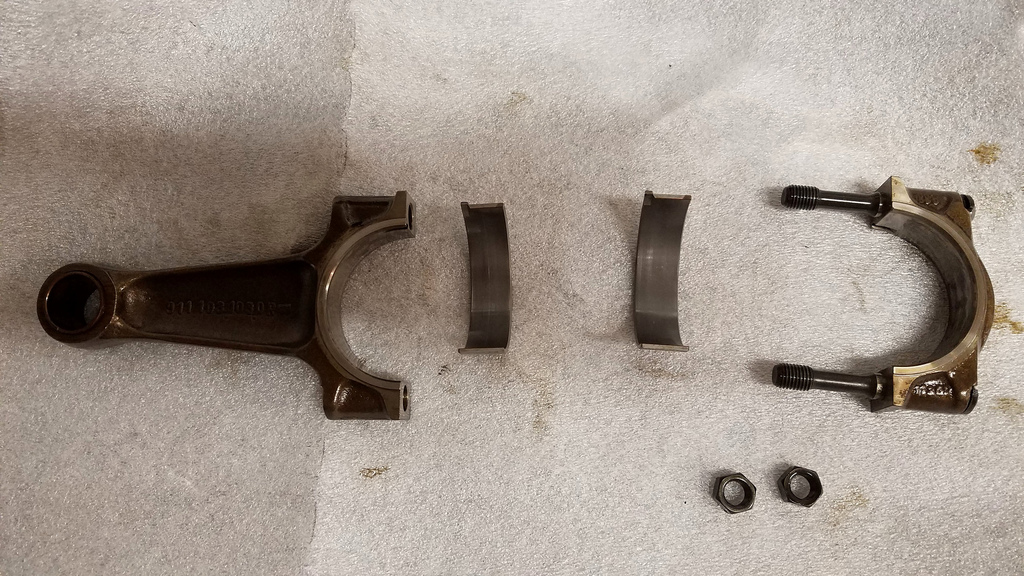

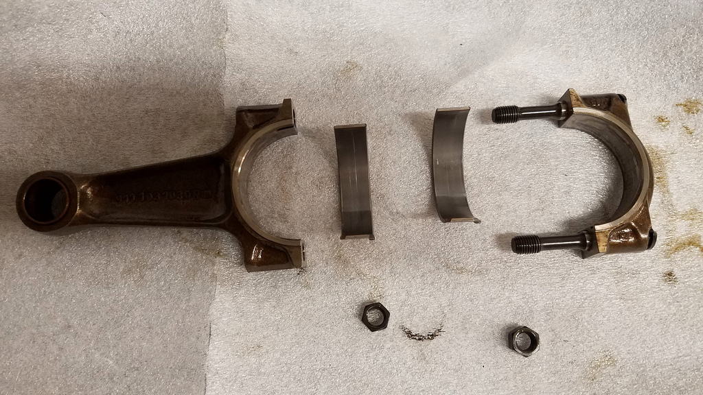

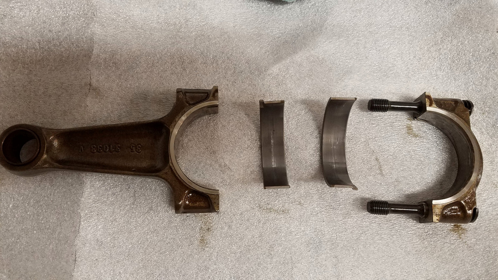

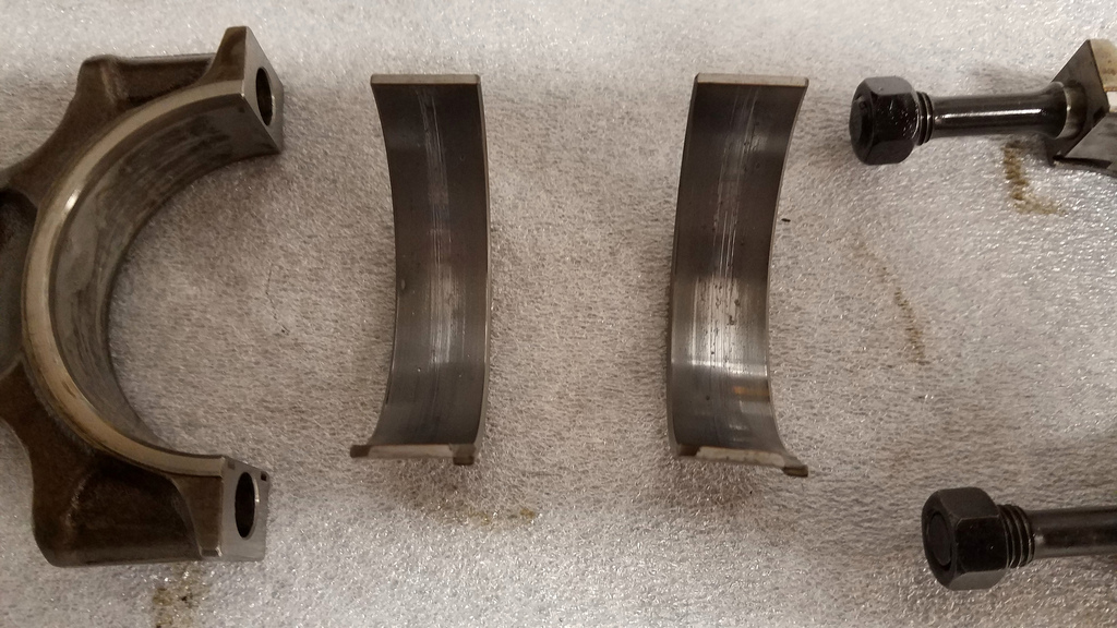

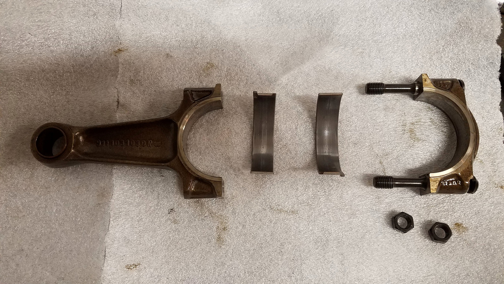

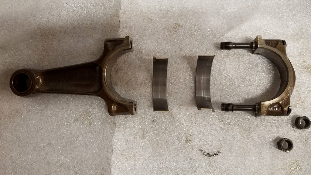

All of the big end rod bearings have significantly more wear than the crank main bearings.
Rod #1
(IMG:http://www.914world.com/bbs2/uploads_offsite/c1.staticflickr.com-19709-1500480454.2.jpg)
Rod #2
(IMG:http://www.914world.com/bbs2/uploads_offsite/c1.staticflickr.com-19709-1500480454.3.jpg)
Rod #3 (probably the worst of them)
(IMG:http://www.914world.com/bbs2/uploads_offsite/c1.staticflickr.com-19709-1500480454.4.jpg)
Rod #4
(IMG:http://www.914world.com/bbs2/uploads_offsite/c1.staticflickr.com-19709-1500480455.5.jpg)

Rod #6
(IMG:http://www.914world.com/bbs2/uploads_offsite/c1.staticflickr.com-19709-1500480455.7.jpg)

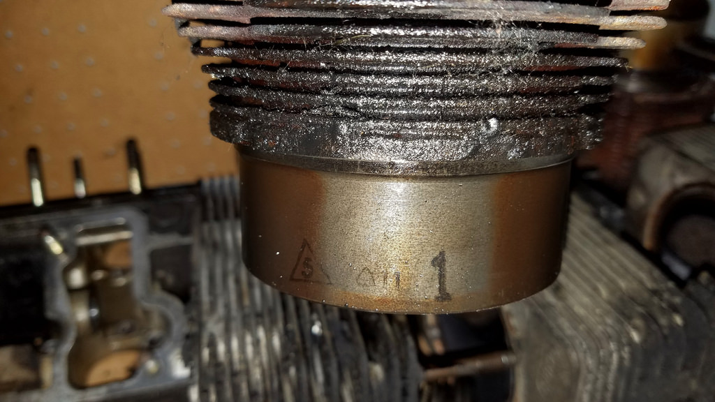

Finally, I didn't clean this part up at all but wanted to snap a pic of the cylinder markings.
