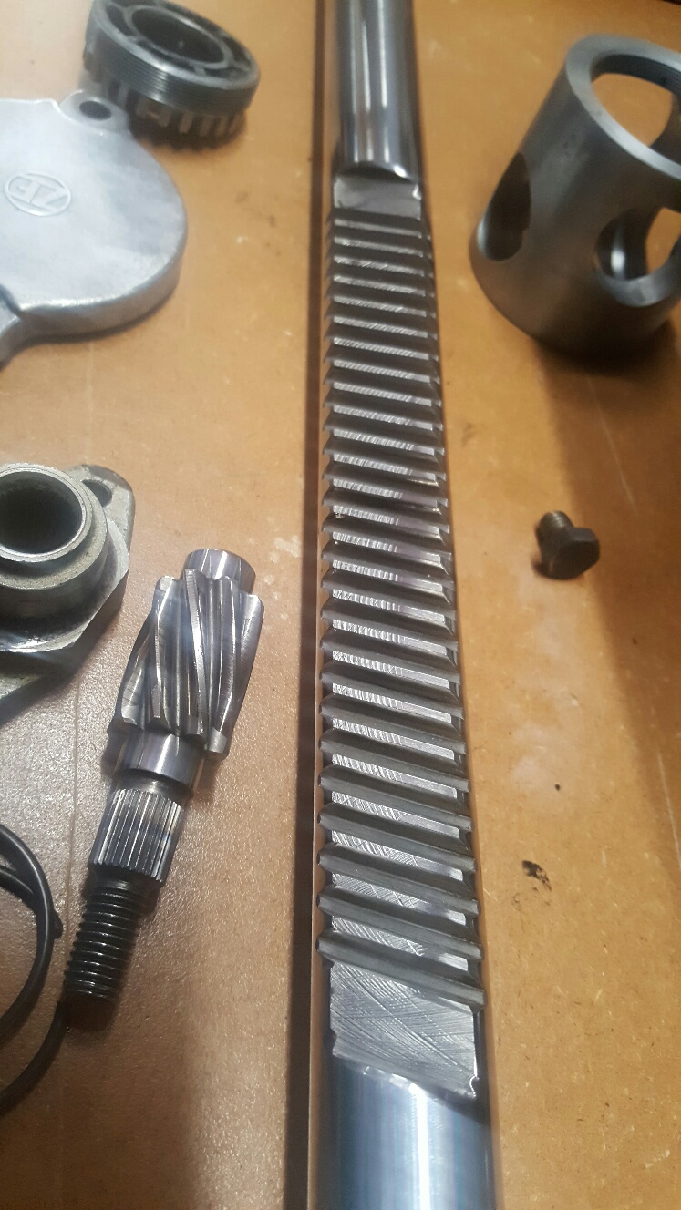

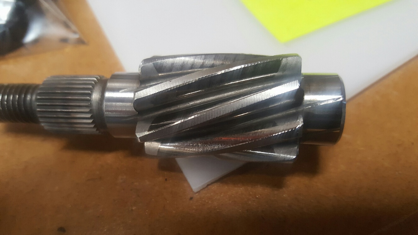

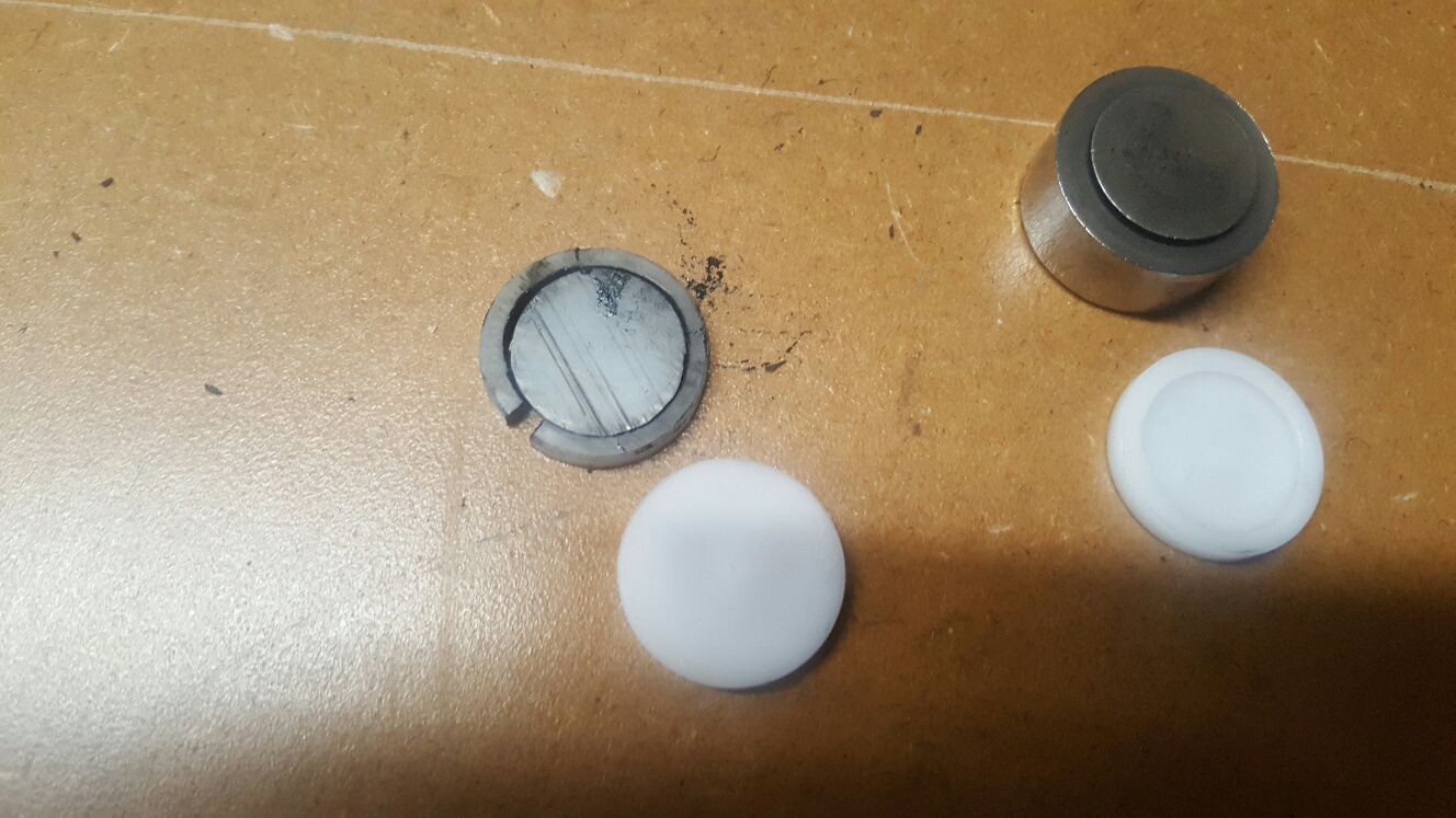

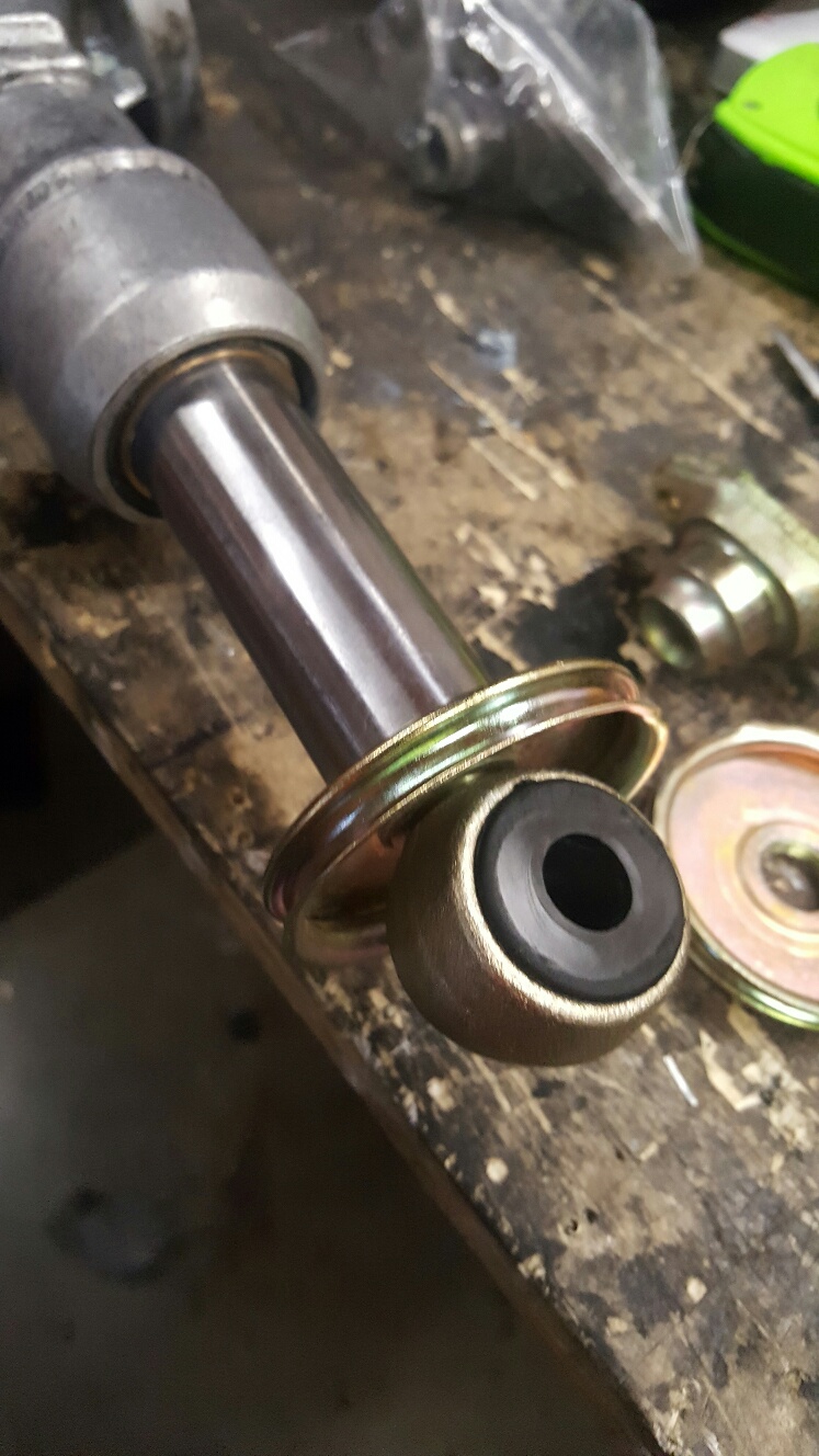

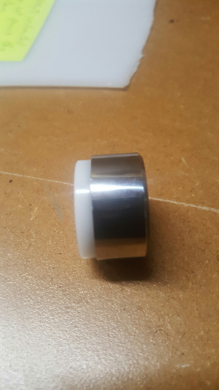

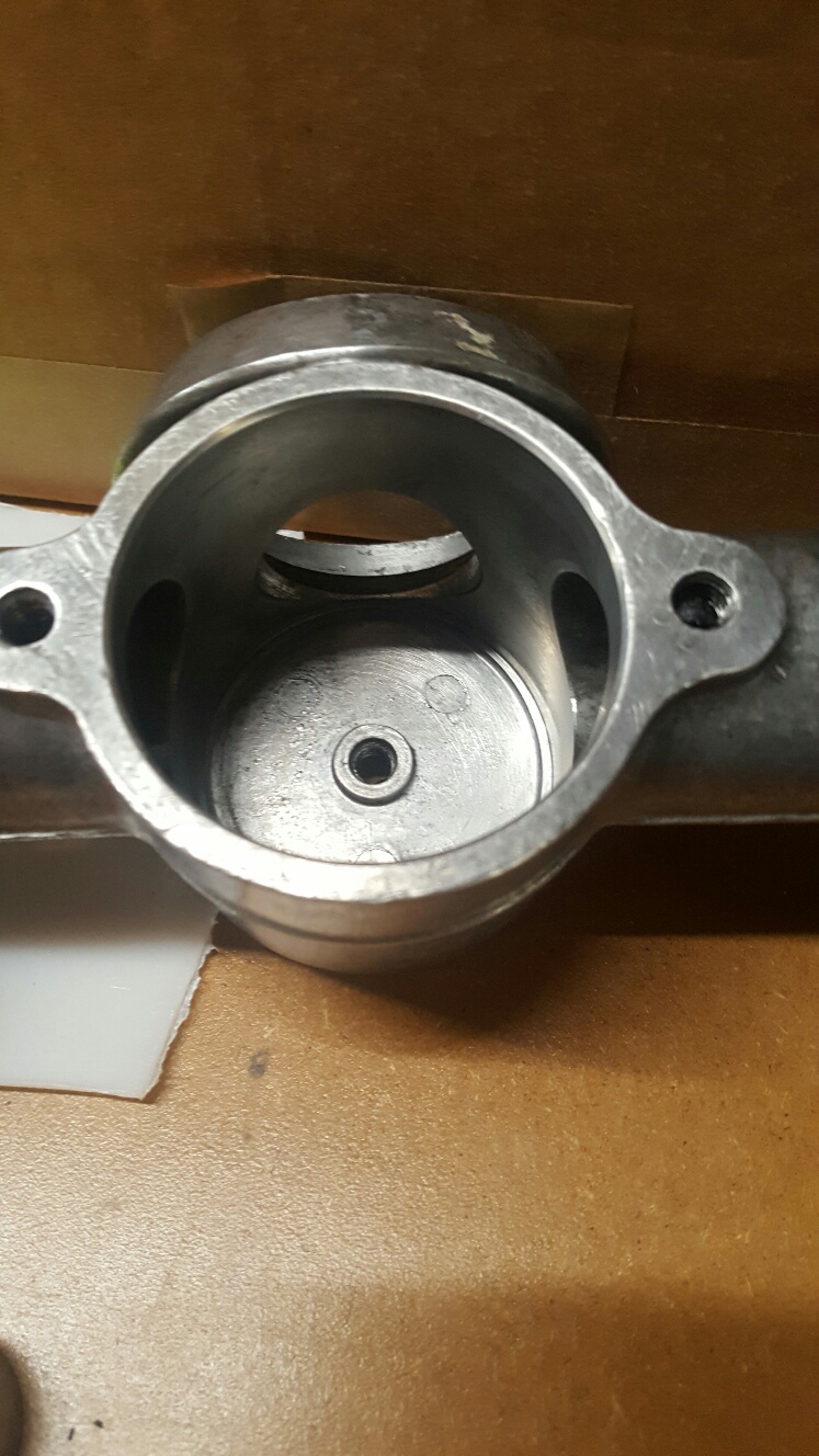

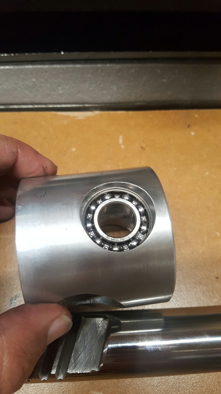

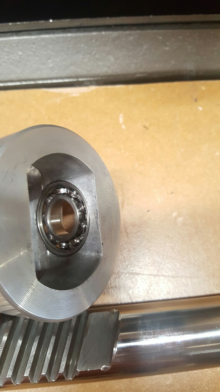

Been a little busy actually working on an oddball 911 version. We have some that are stripped down and are starting to build these and can do an exchange basis or rebuild yours is you want. Exchange we are about 2 weeks out from being able to open up the service and ship (we are starting to build up a few).
If you want yours rebuilt it will take a little longer to turn around. We are looking at a $300 core (why so much? we want them back).
With a serviceable core we can do these at $220+ shipping. A little more than 1st planned, but cleaning these up takes a little more time. We then buff the internals to look for any pitting or damage.
Here's some pics from the one I'm just about finished with.
Would have been more impressive if we had more before pics
Attached Image Attached Image Attached Image Attached Image Attached Image Attached Image Attached Image Attached Image

Mikey914   Been a little busy actually working on an oddball ...   Jul 19 2017, 01:21 AM
Mikey914   A few more   Jul 19 2017, 01:25 AM
