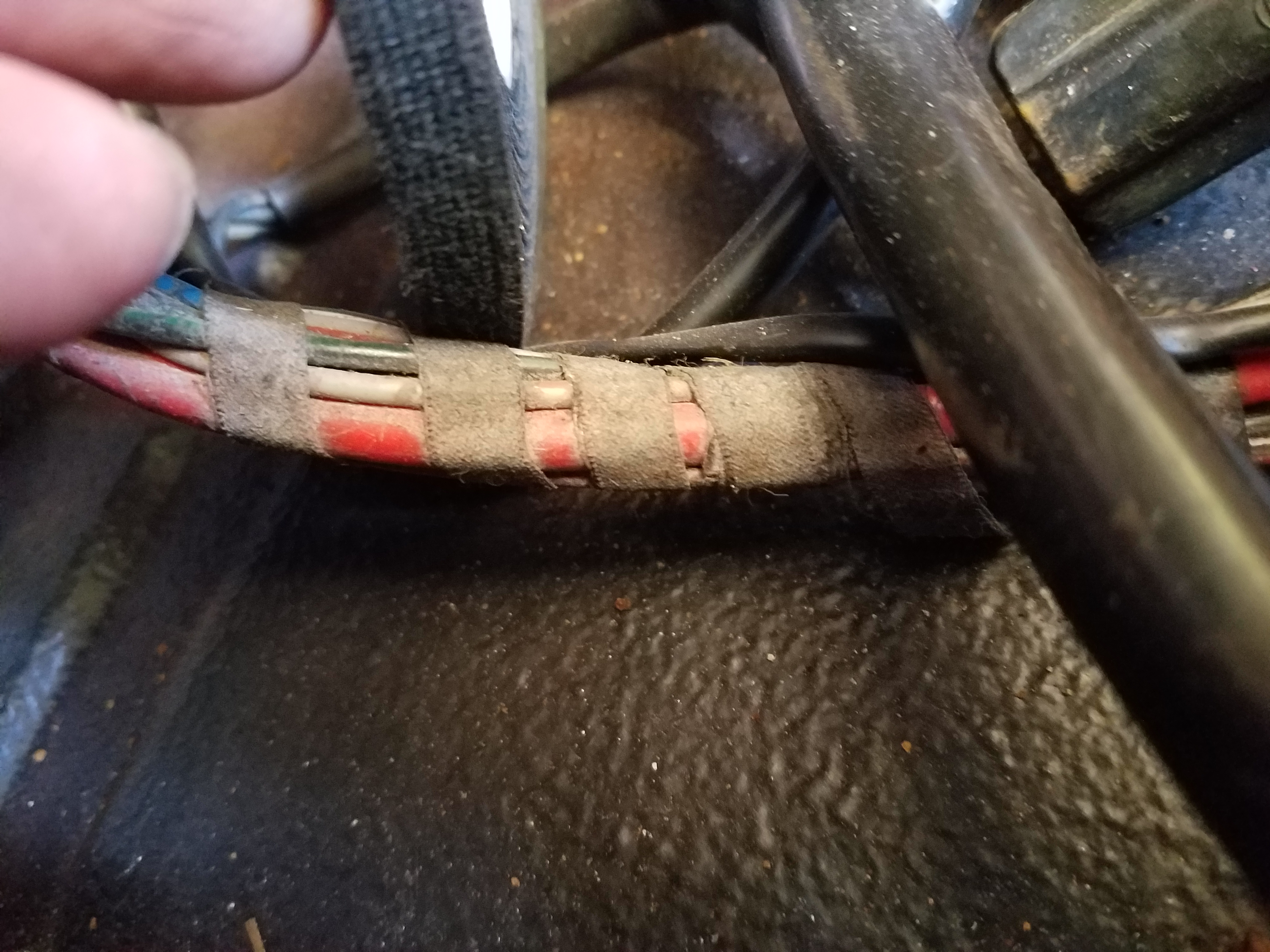

The width of the original tape is about .330". Although gaffer's tape is a very close substitute, that width is simply not available.
So.....
Creative lathing ensues. Place roll of three inch gaffer's tape in the lathe and set up a new razor blade in the tool holder....
Look at that nice clean cut. It's the dark one that's barely visible. 90 rpm and the blade cut in neatly. Now I have some tape to work on Byron's /6 harness.

The tape I am using is the correct width.

Matty900   The tape I am using is the correct width.   Jul 21 2017, 12:58 PM
Matty900   I had wrapped it with the wrong width and then I u...   Jul 21 2017, 01:00 PM
raynekat   You can see how much wider the typical 15mm tape l...   Jul 21 2017, 01:51 PM
