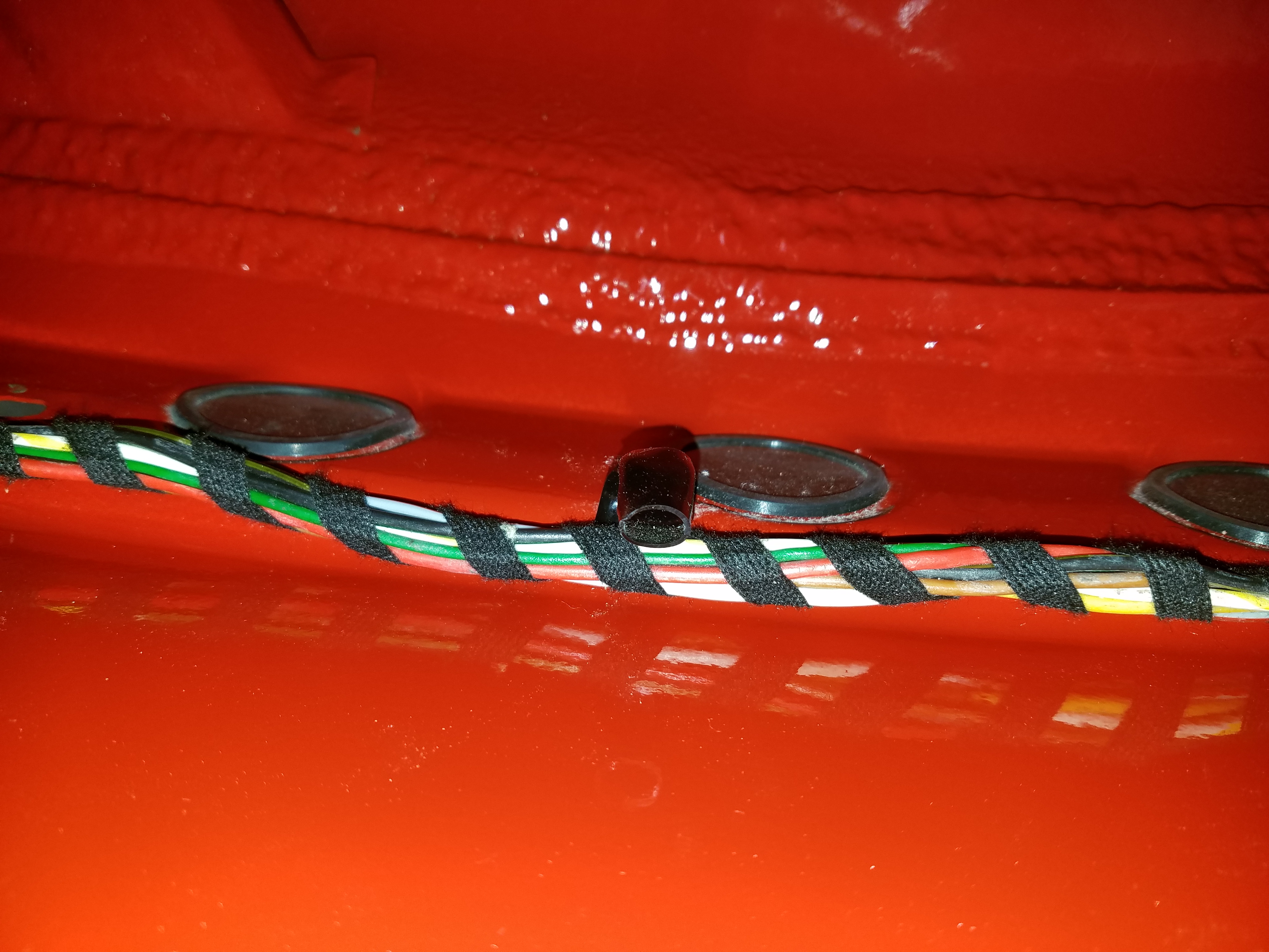

Matty900
post Jul 21 2017, 01:00 PM
Posts: 1,319
Joined: 21-February 15
From: Oregon
Member No.: 18,454
I had wrapped it with the wrong width and then I undid it and rewrapped it yesterday with the correct width. Also put in our new material for covering the metal tabs on the wiring harness connection to the body. Yes these do need to get listed on the website but I'm working on the car today

Matty900   The tape I am using is the correct width.   Jul 21 2017, 12:58 PM
Matty900   I had wrapped it with the wrong width and then I u...   Jul 21 2017, 01:00 PM
raynekat   You can see how much wider the typical 15mm tape l...   Jul 21 2017, 01:51 PM
