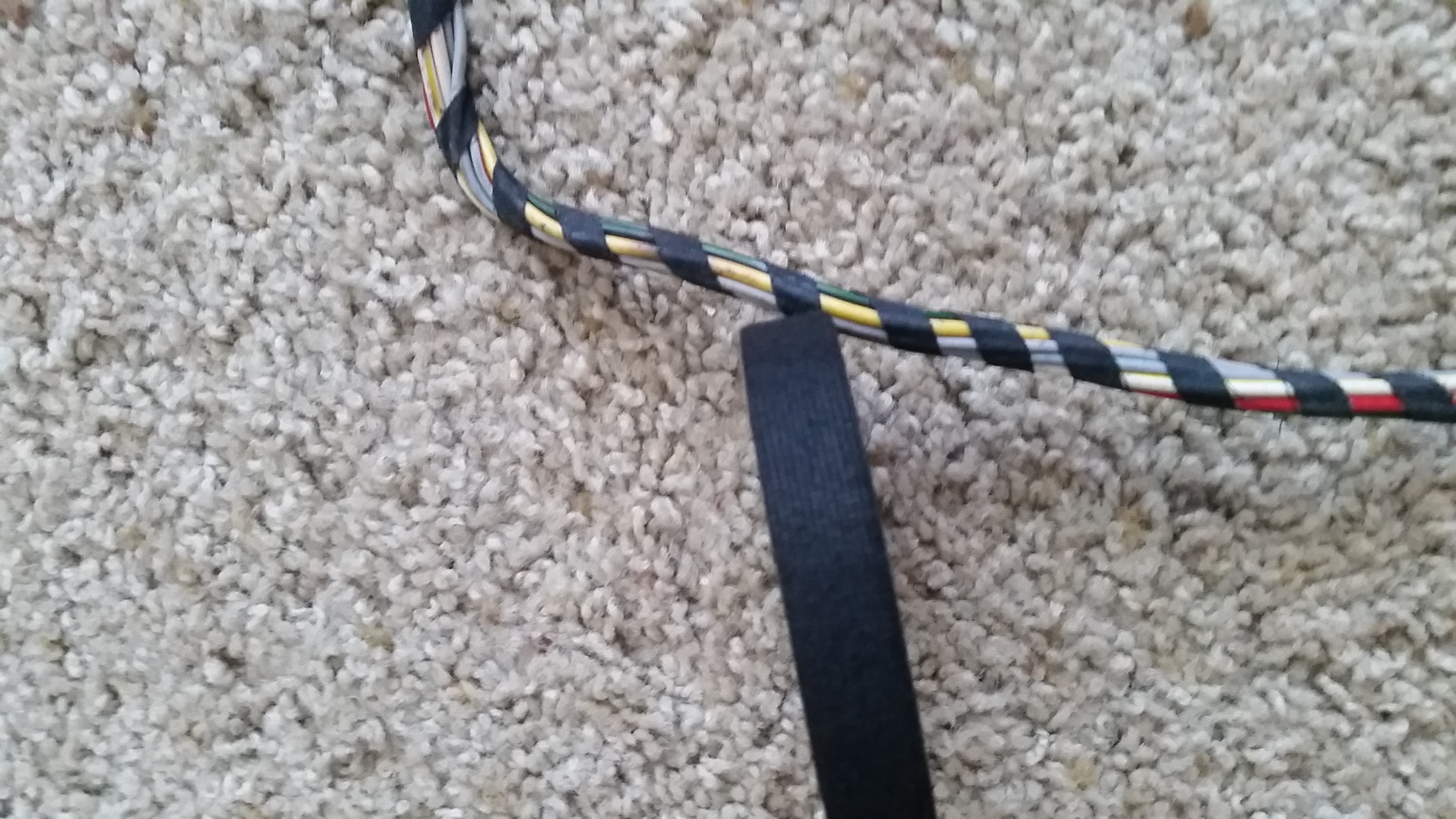

You can see how much wider the typical 15mm tape like Tesa is.
The harness the Tesa tape is next to is NOS 1971 914-4.
The correct width is about 8mm as far as width goes.
Your tape width looks "spot on" Matty.
