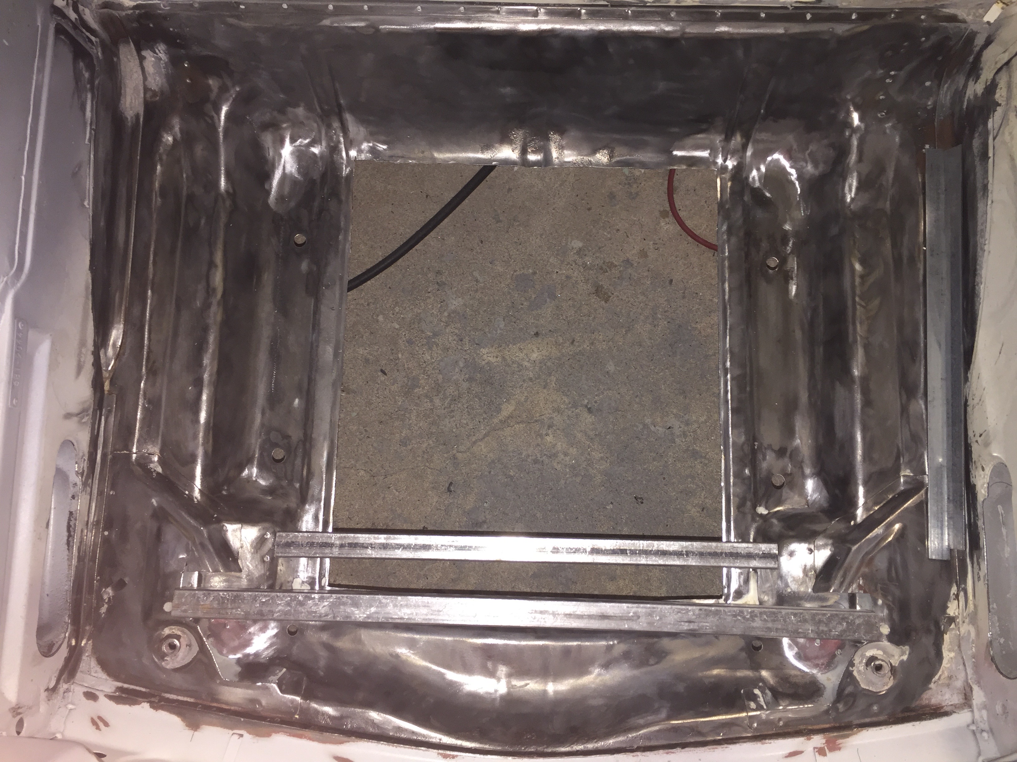

Saturday's project is to finish fitting the braces shown in the pic below, and weld them in. I really liked what Armando did to his car as shown in his "Last New 914-6 GT Project" thread, so I'm using his ideas.
I'll also weld in sheet metal for the floor defining the outlet vent for the cooler.

Mitox   Saturday's project is to finish fitting the br...   Jul 21 2017, 08:14 PM

defianty   Good work, I was going to make my front trunk floo...   Jul 22 2017, 07:57 AM
Mitox   Good work, I was going to make my front trunk flo...   Jul 22 2017, 09:09 AM

Mitox   I completed the front trunk floor welding last wee...   Aug 6 2017, 09:03 PM
Mitox   Here the almost finished shot. Needs minor smooth...   Aug 6 2017, 09:09 PM
