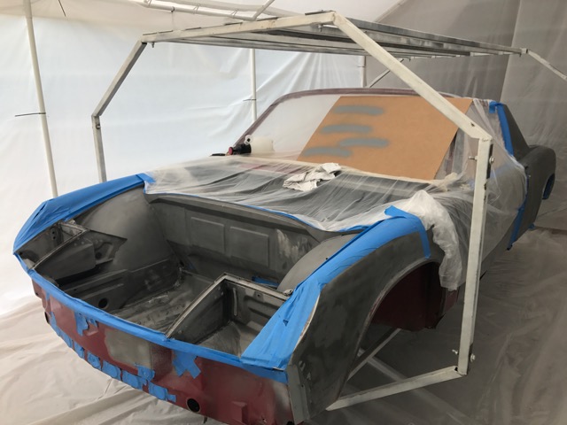

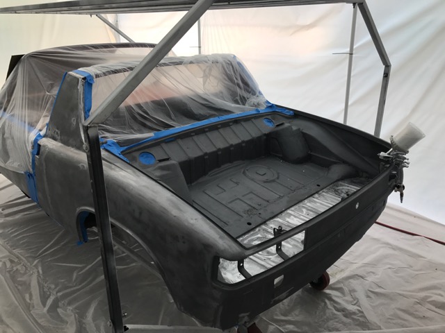

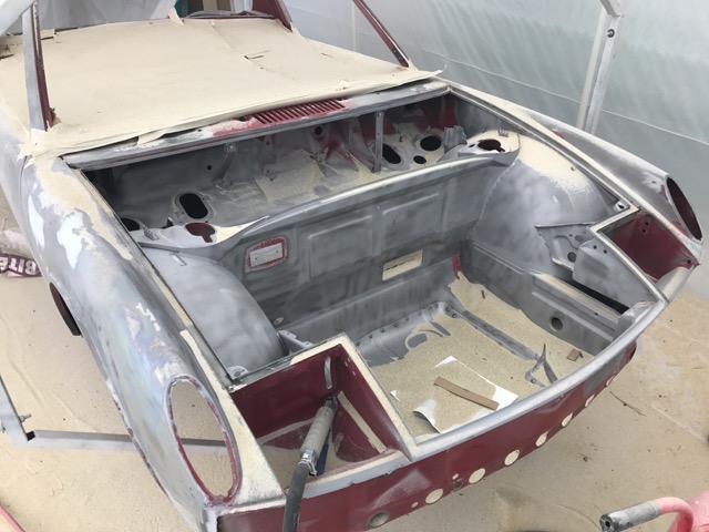

This weekend we built a temporary blast / spray "booth" to do some sand blasting and get some epoxy primer on the car. I'm doing the stripping / spraying in stages. Its' not ideal but it keeps me and the project moving. Man, I forgot how much work sandblasting is. It sure seemed to go quicker when I was blasting my beetle.
Here are some pics inside the booth. Ignore the spot blaster, all of this work was done with a Harbor Freight 100lb blaster and "clean bite" glass media.
(IMG:http://www.914world.com/bbs2/uploads_offsite/i.imgur.com-19557-1500871610.2.jpg)
(IMG:http://www.914world.com/bbs2/uploads_offsite/i.imgur.com-19557-1500871610.3.jpg)
(IMG:http://www.914world.com/bbs2/uploads_offsite/i.imgur.com-19557-1500871610.4.jpg)
(IMG:http://www.914world.com/bbs2/uploads_offsite/i.imgur.com-19557-1500871610.5.jpg)

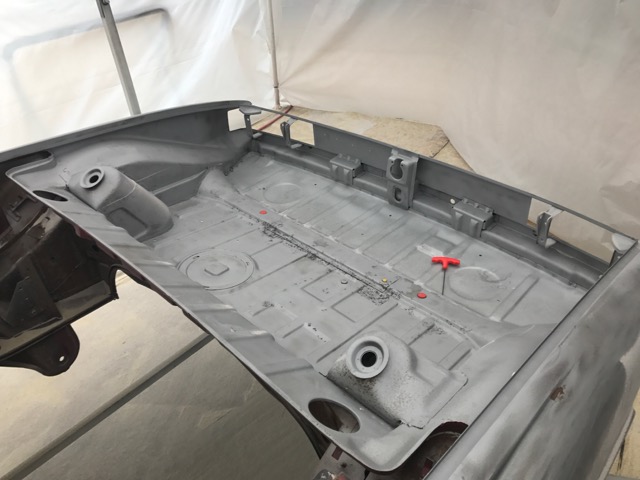

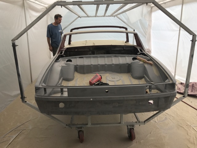

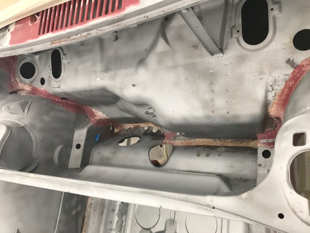

I ended up taking the rest of the seam sealer out of the front compartment of the front trunk. I'm too afraid of rust hiding out underneath the original sealer. I am going to order an air needle scaler to tackle the tight spaces of the back compartment of the front trunk.
After blasting, I wiped down the fresh metal with Picklex20. Here are some pics after cleaning & tack ragging:
(IMG:http://www.914world.com/bbs2/uploads_offsite/i.imgur.com-19557-1500871611.6.jpg)
(IMG:http://www.914world.com/bbs2/uploads_offsite/i.imgur.com-19557-1500871611.7.jpg)

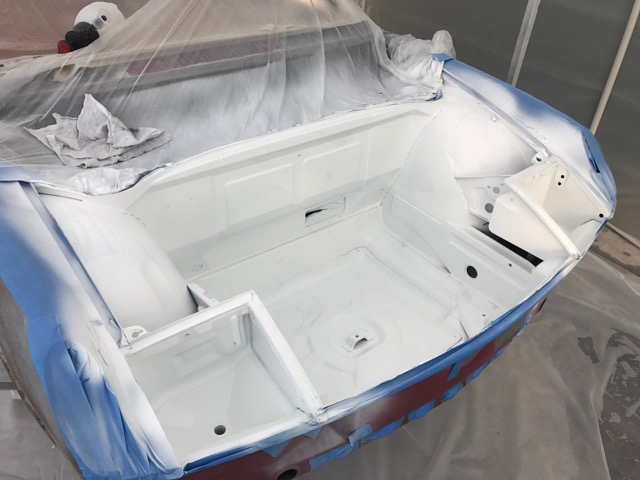

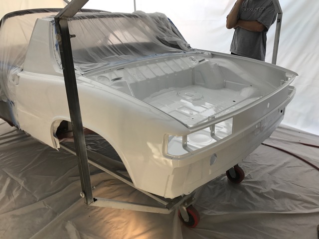

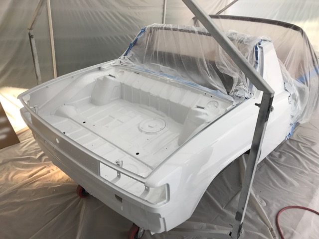

Lastly, here she is after Eastwood epoxy primer in white:
(IMG:http://www.914world.com/bbs2/uploads_offsite/i.imgur.com-19557-1500871611.8.jpg)
(IMG:http://www.914world.com/bbs2/uploads_offsite/i.imgur.com-19557-1500871611.9.jpg)
(IMG:http://www.914world.com/bbs2/uploads_offsite/i.imgur.com-19557-1500871612.10.jpg)
