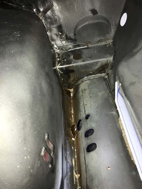

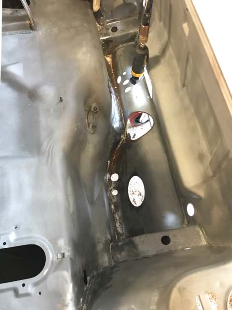

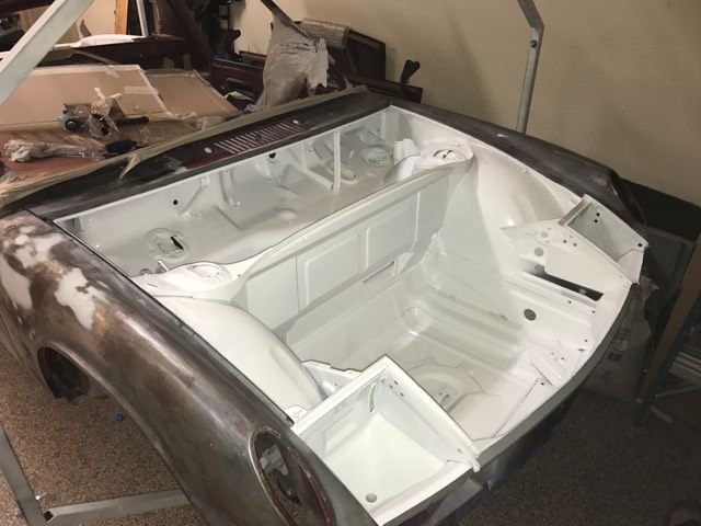

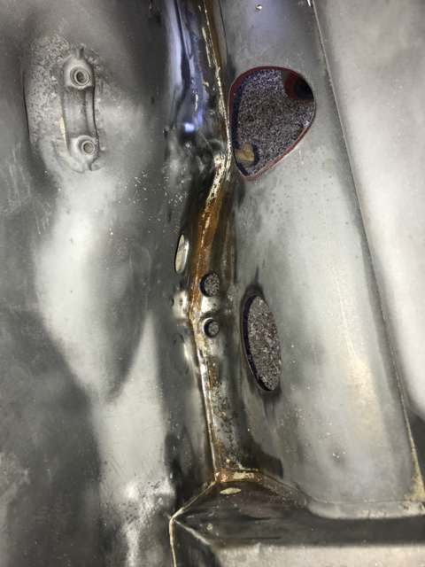

I finished cleaning up the back half of the front trunk and sure enough found some rust under the factory seam sealer. This was a lot of work... it took two of us 2 hours or so picking away with about 10 different tools to get it all out.
(IMG:http://www.914world.com/bbs2/uploads_offsite/i.imgur.com-19557-1501043457.1.jpg)
(IMG:http://www.914world.com/bbs2/uploads_offsite/i.imgur.com-19557-1501043457.2.jpg)
(IMG:http://www.914world.com/bbs2/uploads_offsite/i.imgur.com-19557-1501043457.3.jpg)

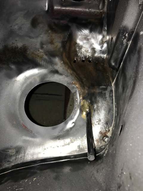

Accidentally punched a hole through here, will have to repair:
(IMG:http://www.914world.com/bbs2/uploads_offsite/i.imgur.com-19557-1501043457.4.jpg)

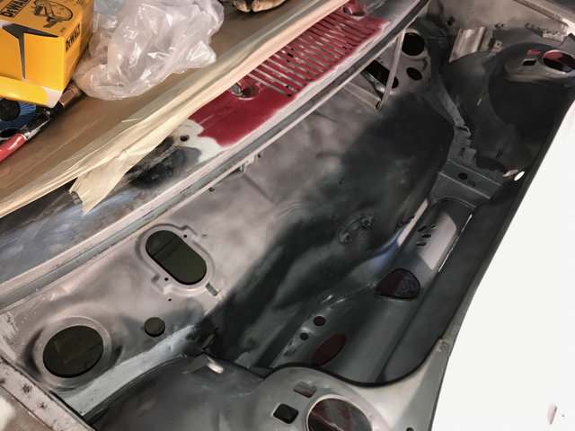

Hard to see in this pic, but I decided to put a coat of master series over the seam line to encapsulate and treat any rust before epoxy:
(IMG:http://www.914world.com/bbs2/uploads_offsite/i.imgur.com-19557-1501043458.5.jpg)

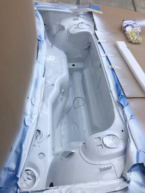

Here she is in epoxy primer:
(IMG:http://www.914world.com/bbs2/uploads_offsite/i.imgur.com-19557-1501043458.6.jpg)
(IMG:http://www.914world.com/bbs2/uploads_offsite/i.imgur.com-19557-1501043458.7.jpg)
I also starting working on filler in a few small dings. I'm dreading stripping the rest of the paint on the bottom of the car, but I know that needs to come first.
