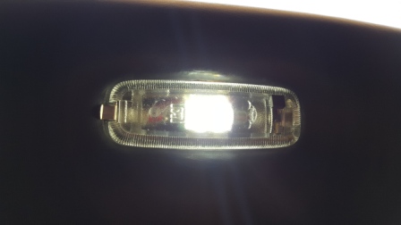

Ok....so follow up to this broken crappy replacement interior light and overheating.
Bought a replacement lens from Pelican which comes with the crappy filament bulb which overheats. Also another crappy design since the bulb rotates in the holder when the switch is moved.
Found a Dorman LED for 10 bucks, soldered the leads to the bulb holder and then glue gunned in the LED board to the lens....carefully.
Viola.
