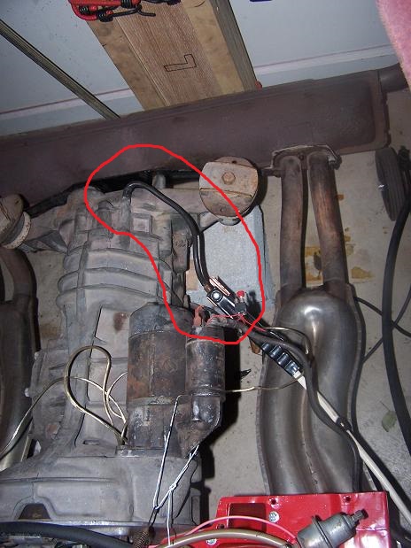

Here's a pic of the ground strap I'm using. I think it's 1 ft and 2ga.

Spoke   Here's a pic of the ground strap I'm using...   Aug 9 2017, 01:05 PM
