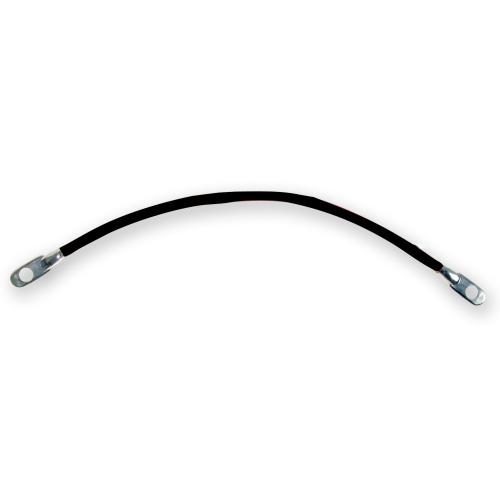

I installed a new ground from the rearmost engine case bolt to the battery ground stud on the passenger side of the engine compartment. I used a generic 4 ga battery ground cable from my FLAPS. One end is on top of the battery ground cable. The other is on the bolt that holds the oil bath air cleaner "shelf". This end of the cable is sandwiched between 2 washers on top of the shelf arm that the bolt goes through, with the nut holding it all down tight.

If the spring heats up while running, then your alternator is grounding through the spring. Did you have the engine out and do some painting on the fan shroud? If you add a ground strap to the alternator, attach the other end to the engine case, not the fan shroud. The alternator already is grounded to the fan shroud.
BTW, for a transmission ground strap, I picked up a standard starter cable like this one at my FLAPS. I think the one I picked up was either 2ga or 4ga 12 inches long. It was longer than the original so I looped it once.
Starter Cable
Starter Cable
The starter has always sounded and run strong. That's kinda why all the discussion around the transmission ground strap always seems to come back to talk about how well the starter pulls - this puzzled me. Mine seems fine. That's what led to the idea of the extra ground for the engine and not straight to the transmission.
I have not had the engine out of the car.
The new ground cable I bought looks exactly like the one you pictured. It's the one from the rearmost case bolt in the engine compartment going straight to the battery's ground post.
I'll look at the transmission ground and also look into a supplemental ground for the alternator. I finally got her off the jack stands. I guess she missed them!!
