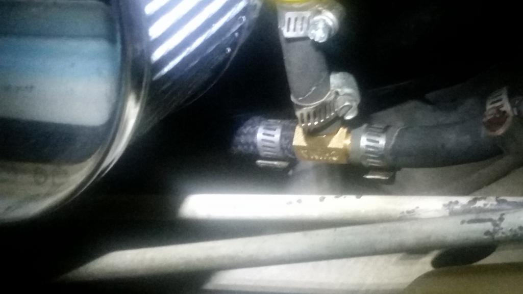

Its get wet around the
Gold tee and surrounding 3 closest clamps And will drip a nice puddle but as soon as the car is running driving Drip go's away , even after turning off the car and restarting Never comes back until the next sunday drive . But then there it is again Bolt clamps are swiveled around So i cant really reach them |

JawjaPorsche Replace those clamps with fuel injection clamps. ... Aug 12 2017, 05:13 AM

mepstein :agree: Need proper clamps and the hose might be... Aug 12 2017, 05:26 AM
76-914 :agree: & Is the Tee a barbed fitting or thr... Aug 12 2017, 07:27 AM

rhodyguy What is that white line on the verticle hose in po... Aug 13 2017, 11:54 AM
Elliot Cannon Replace them. Replace them all. NOW. New prope... Aug 13 2017, 10:17 PM
