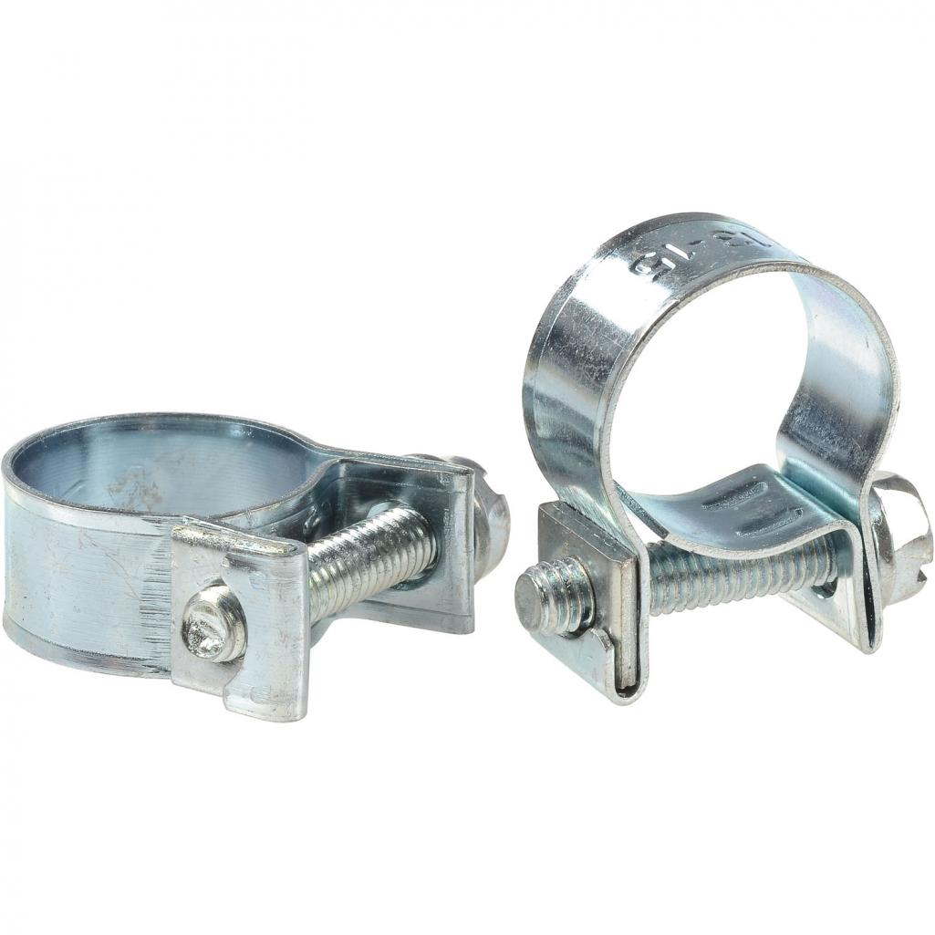

Its get wet around the
Gold tee and surrounding 3 closest clamps And will drip a nice puddle but as soon as the car is running driving Drip go's away , even after turning off the car and restarting Never comes back until the next sunday drive . But then there it is again Bolt clamps are swiveled around So i cant really reach them |

Replace those clamps with fuel injection clamps. Your clamps can cause leaks.
