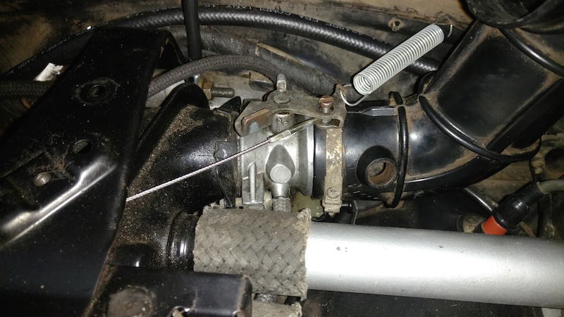

Got the FI back in my car (1970 1.7L) and working recently. The PO had cut the throttle cable for the carb conversion, so I installed a new TerryCable.
I noticed that the throttle cable got hot. I figured that the ground strap was corroded or broken (I can see it, but can't get to it now.) I installed a new ground from the rearmost engine case bolt to the battery ground stud on the passenger side of the engine compartment. I used a generic 4 ga battery ground cable from my FLAPS. One end is on top of the battery ground cable. The other is on the bolt that holds the oil bath air cleaner "shelf". This end of the cable is sandwiched between 2 washers on top of the shelf arm that the bolt goes through, with the nut holding it all down tight. I cranked the car and it ran easily, and the throttle cable was no longer hot, or even warm. Success? Not so fast... I then replaced the bushings in the accelerator pedal bracket, so it's nice and smooth now. Didn't get a chance to crank it because I ran out of time that day. I cranked it today, and blipped the throttle by hand on the throttle body. I thought I saw a tiny spark at the throttle return spring where it attaches to the rear wall. I touched the spring lightly with my finger and burned the crap out of it! The engine had been running only about 10 seconds at this point. What gives? Theory: The new accelerator pedal bushings improved the electrical connection to the body. The new grounding cable isn't making good enough contact to the engine case, so the engine is still preferring to ground through the throttle cable. Assumption: A 4ga cable connected from the engine case straight to the body where the battery connects is an equal (if not superior) ground compared to the transmission ground strap. I still plan on inspecting and possibly replacing the transmission ground strap, but I'm curious as to why I burned my finger... Ideas? Advice? |

I did some voltage testing, all at the battery:
Car off: 12.26v On, not running: 12.1v Running, idle at 1000 rpm: 12.6v Running at 2500 rpm: 13.2v Running at 2500, with throttle cable and return spring disconnected: 13.6v One thing I forgot to test was voltage between the throttle body and chassis with the cable and spring disconnected while running, just for completeness. Here's the picture of my throttle body, with the throttle cable and return spring in place. I did remove the air filter assembly, for clarity. (The fuel line is not as close as it appears to the return spring.) ![]() |

clapeza I did some quick testing this afternoon, and came ... Aug 16 2017, 08:08 PM
Spoke It is possible that AAR wire is shorting to its ca... Aug 17 2017, 04:02 AM
Racer Chris Your plenum must be insulated from the crankcase o... Aug 17 2017, 06:56 AM
clapeza GOT IT!!
I disconnected the wire to the A... Aug 17 2017, 05:46 PM![]() ![]() |
