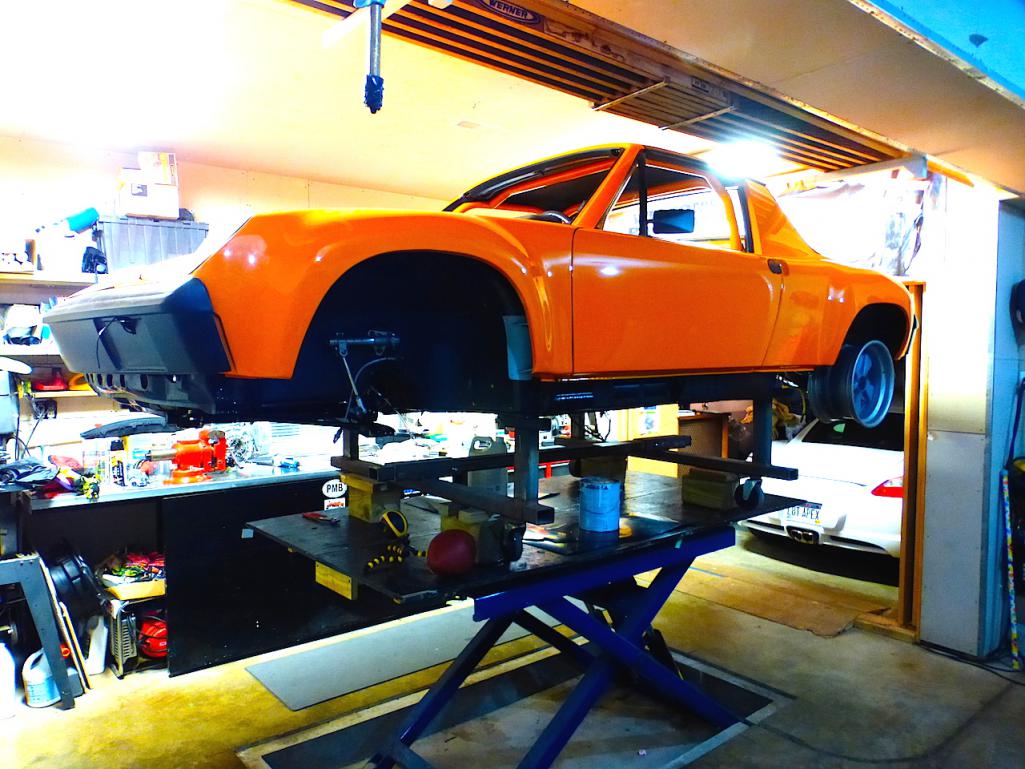

Michael, sounds a little familiar.....you will love it. Best, MarkAttached Image
