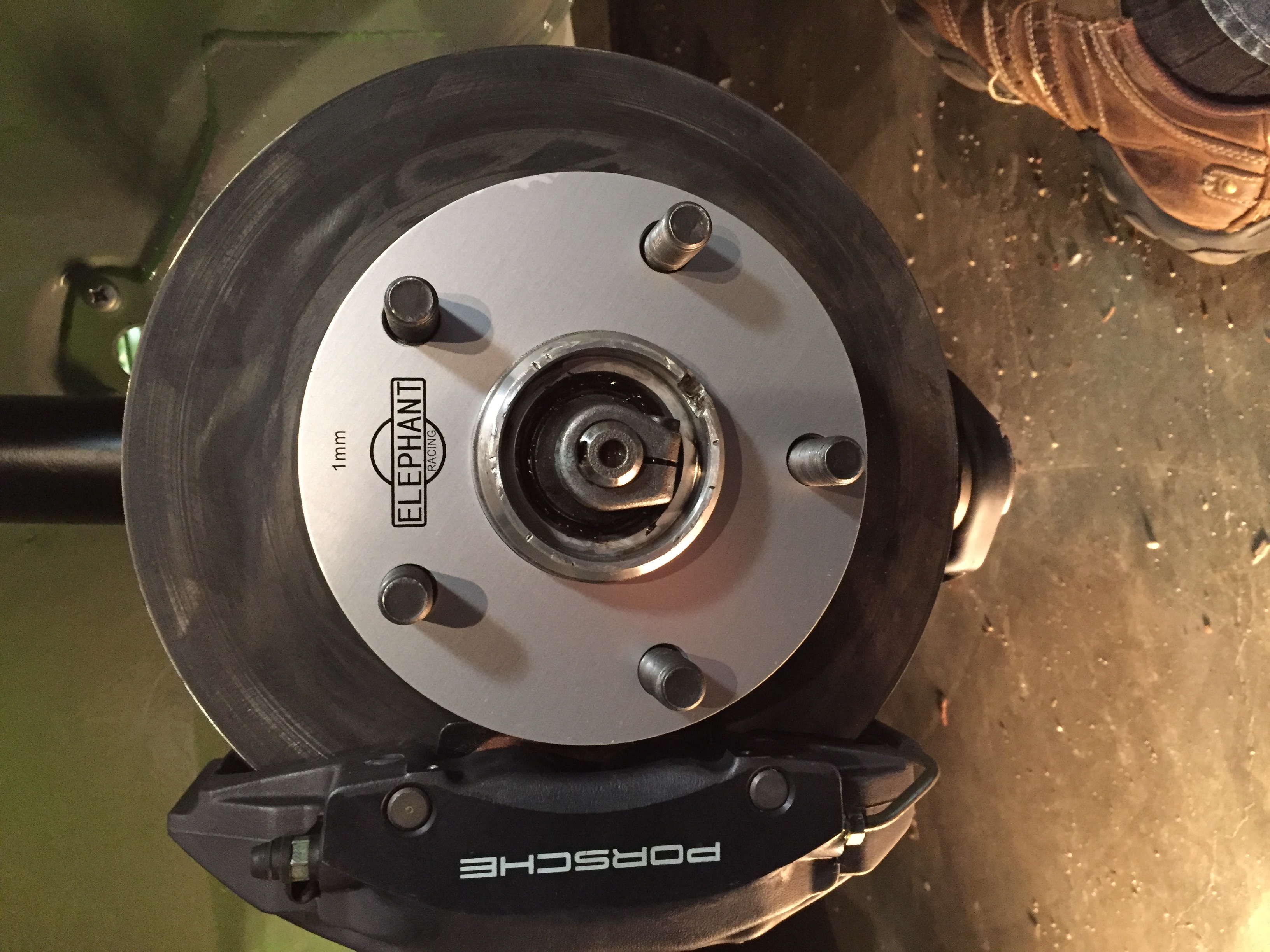

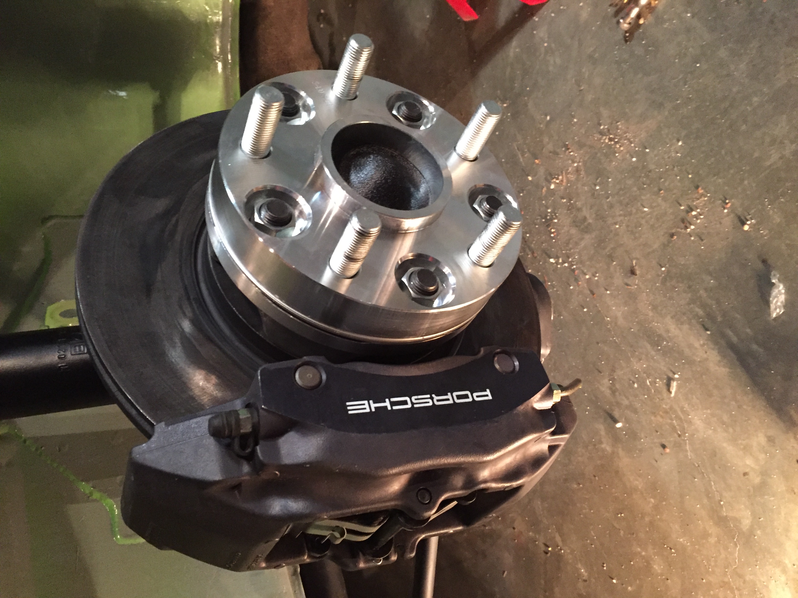

mgp4591   Test fitting the rears - already have the fronts...   Aug 20 2017, 12:09 AM
