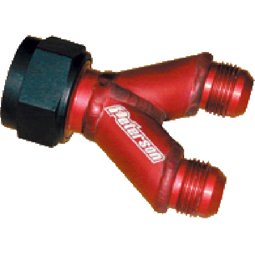

I used all AN fittings and hoses on my water inlet and outlets. I was able to connect the outlets with Peterson Y AN16 fitting. This allowed me to mount my engine about 2 inchs closer to the firewall than the way Renegade does it. This gives a better angle on the axles with the boxster transaxle. All fittings and hoses were bought at a Nascar race shop and were less than the list price of the Y fitting alone.
Y fitting
Hoses
