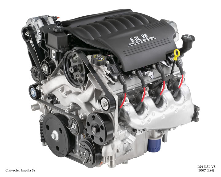

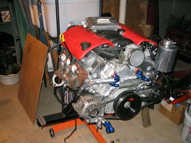

The LS4 has the shortest length of all the LS's. I was trying to be slick by installing this LS4 as it is (fully dressed)

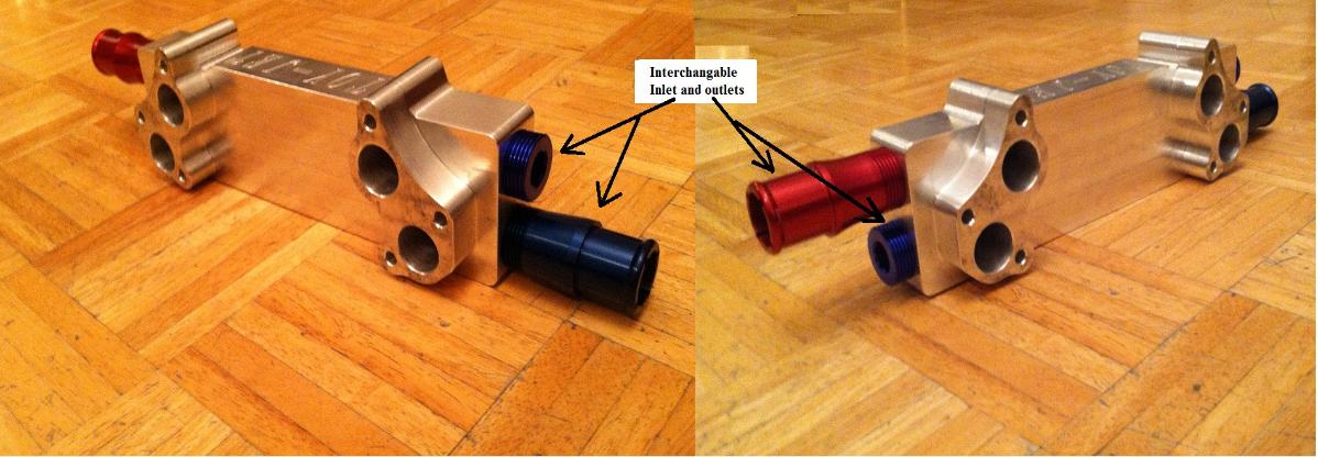

Click to view attachment Look at the entry/exit coolant hose location, it would of been perfect! However, it's been nothing but a fight. I was left with 2 options, undressing the engine to bare block and using Renegade's cooling solution or modify the firewall to accept the LS4 as it is, but faced with a near future consequence of figuring out a custom interior. So, I waved the white flag in defeat and ordered Renegade's cooling kit.
I'll go through your guys build threads, love learning what other people have done. The LS4 sounded good in theory, Renegade Hybrids gave me a tongue lashing to not use it and not to use my wrong year boxster S 6 speed transmission (too new), So I was and currently am out to prove them wrong.
