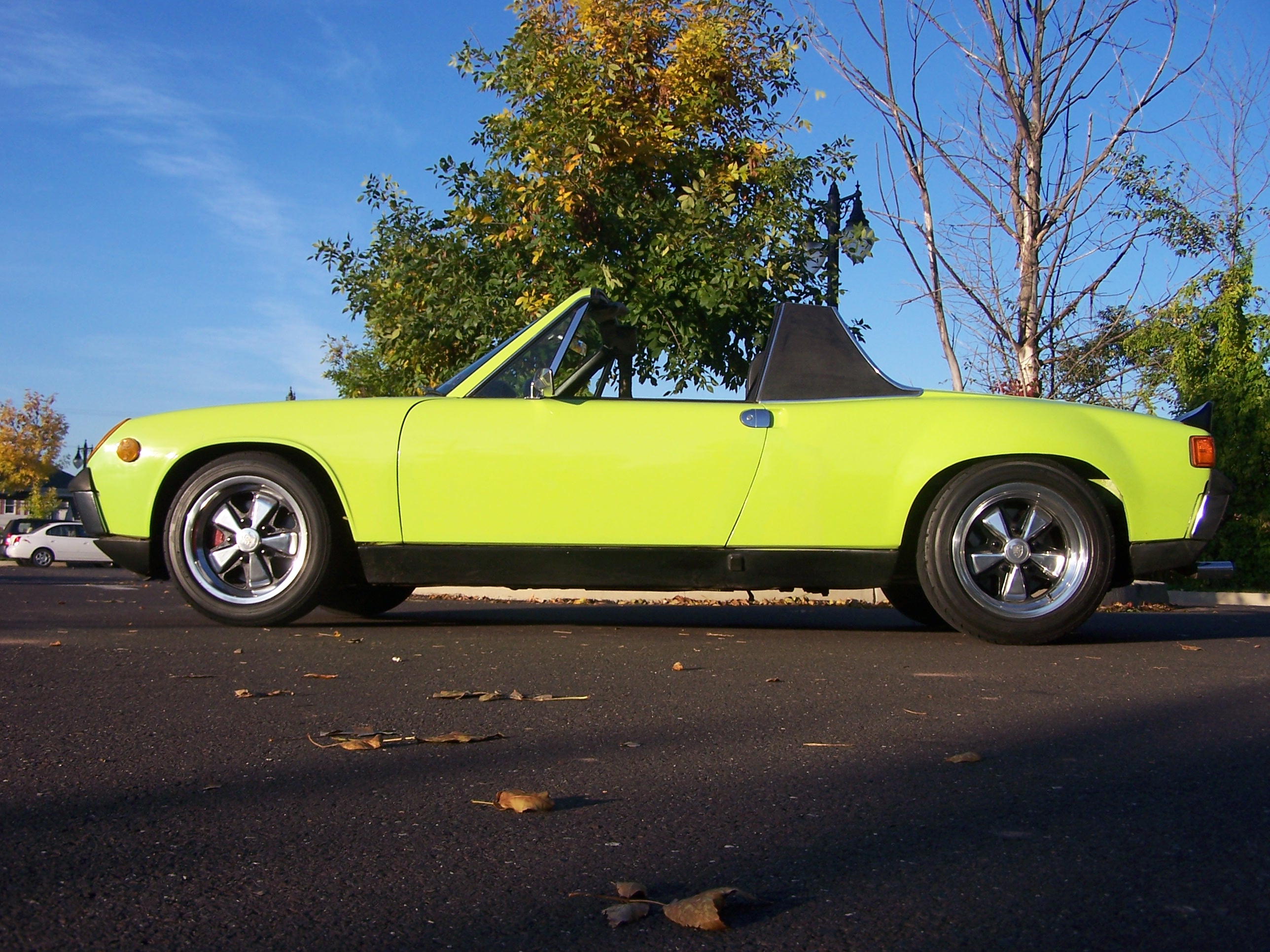

wndsrfr   Here's Lime Green on Kermeee.....   Apr 16 2017, 07:43 PM
