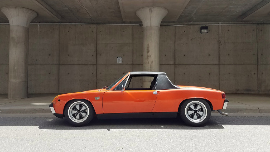

Anyway, the result is good. It's running and driving, the 1911 is strong and runs well. Handles great considering there are no sway bars. Tail shifter is as vague as you imagine though, and the engine is still sub 100hp so it's not incredibly fast.
(IMG:http://www.914world.com/bbs2/uploads_offsite/c1.staticflickr.com-19709-1496565572.1.jpg)
It's first real public appearance was at the June C&C that I attended with a good friend in his 911.

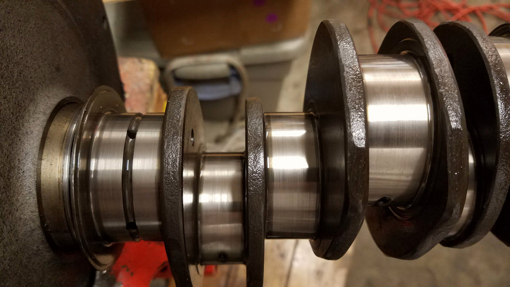

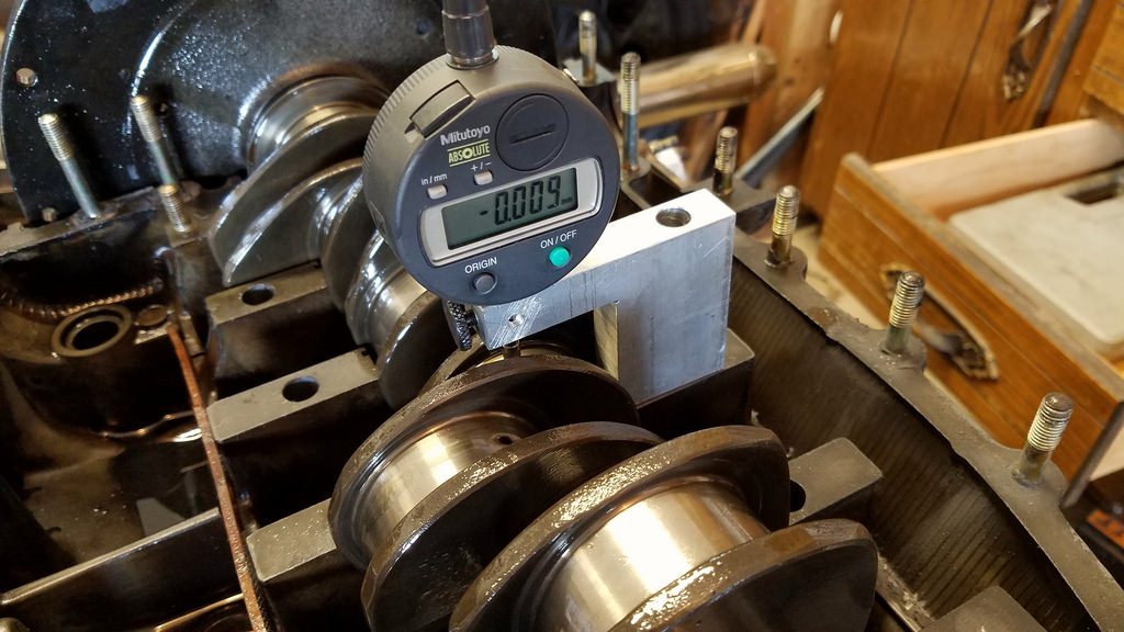

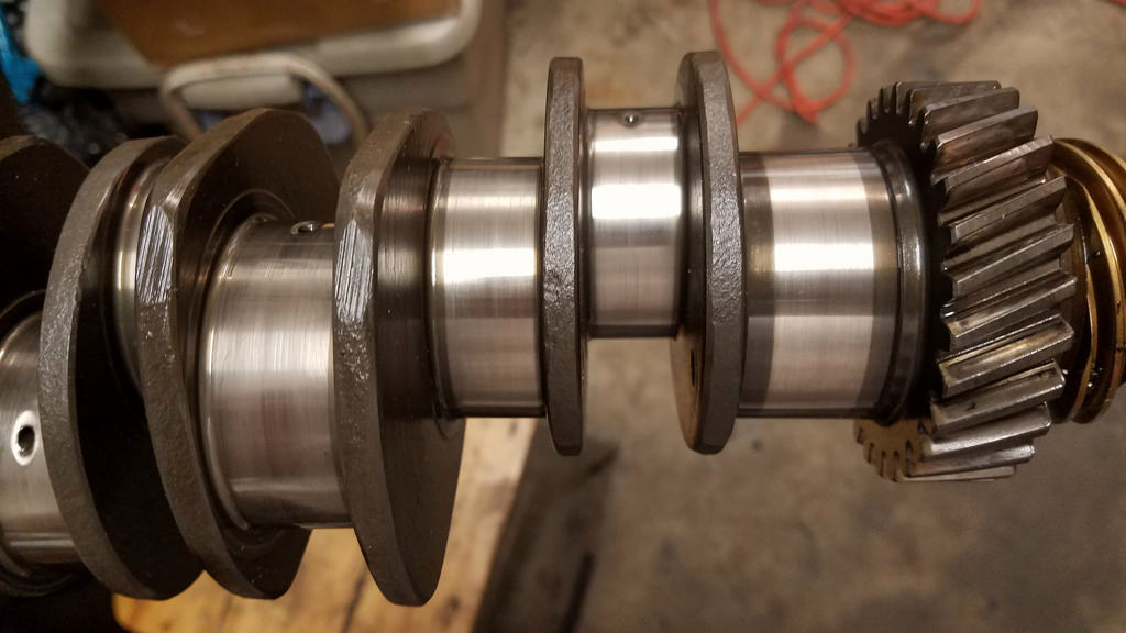

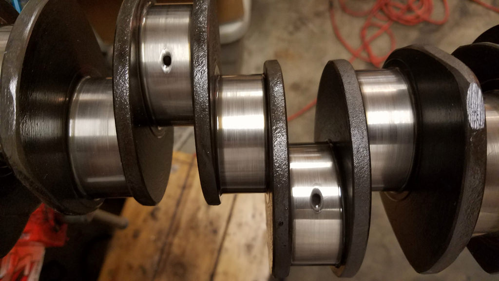

Picked up a new set of Micrometers, and a dial bore gauge. Micrometers measure down to .0001" and bore gauge is metric, measures down to 0.01mm.
Remeasured the crank, all measurements are verified. it's well within spec on all accounts. I will be getting it polished and magnafluxed at a local place on the recommendation of Aaron.
(IMG:http://www.914world.com/bbs2/uploads_offsite/c1.staticflickr.com-19709-1503414556.1.jpg)
(IMG:http://www.914world.com/bbs2/uploads_offsite/c1.staticflickr.com-19709-1503414557.2.jpg)
(IMG:http://www.914world.com/bbs2/uploads_offsite/c1.staticflickr.com-19709-1503414557.3.jpg)
I machined up this bracket to hold the dial gauge, works pretty well.
(IMG:http://www.914world.com/bbs2/uploads_offsite/c1.staticflickr.com-19709-1503414557.4.jpg)

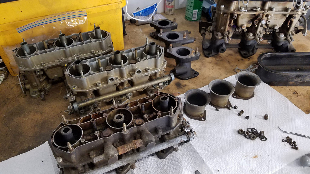

Started tearing down and seeing what I'm dealing with on the carbs.
(IMG:http://www.914world.com/bbs2/uploads_offsite/c1.staticflickr.com-19709-1503414559.9.jpg)
From my research these Zenith 40 TINs are pretty great carbs, just not a lot of room to hop them up for more power. i.e. getting different venturies and jets might be a chore for non-stock configurations.
So I have two sets, I can mix and match parts to get one good set and return the leftovers to Aaron.
One set had a detonation through the intake which started a small fire, the venturies melt easily and a few were beyond repair. This set of carbs is complete, but in poor shape. It's also the set that came with the engine.
The second set is in much better shape, but it's not complete. I'll be rebuilding the second set, and pulling needed parts off the first set.

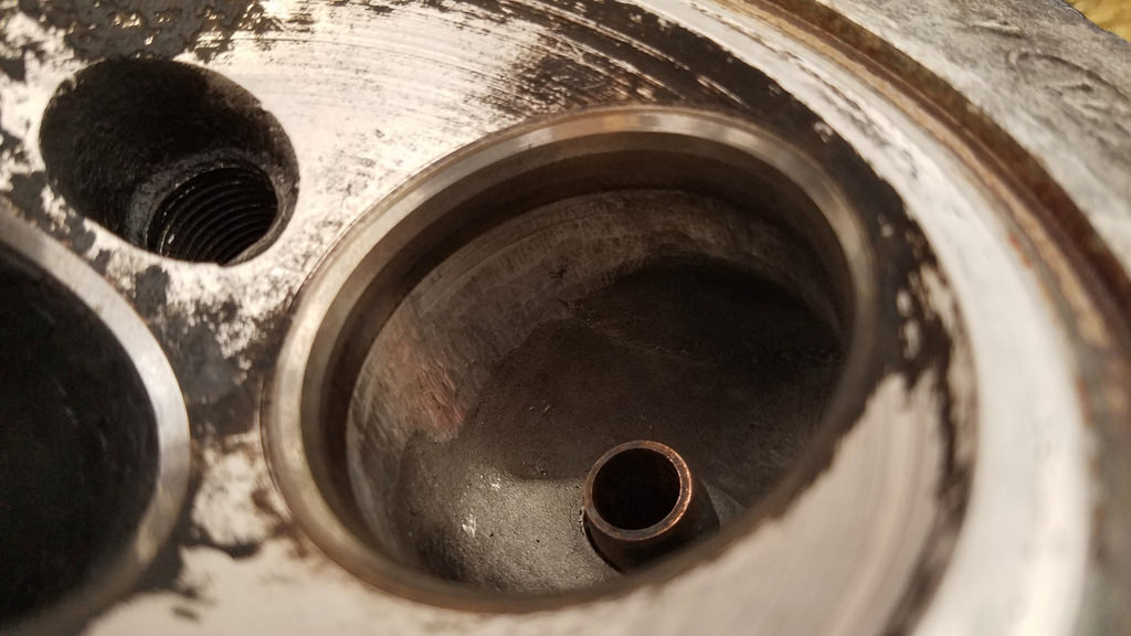

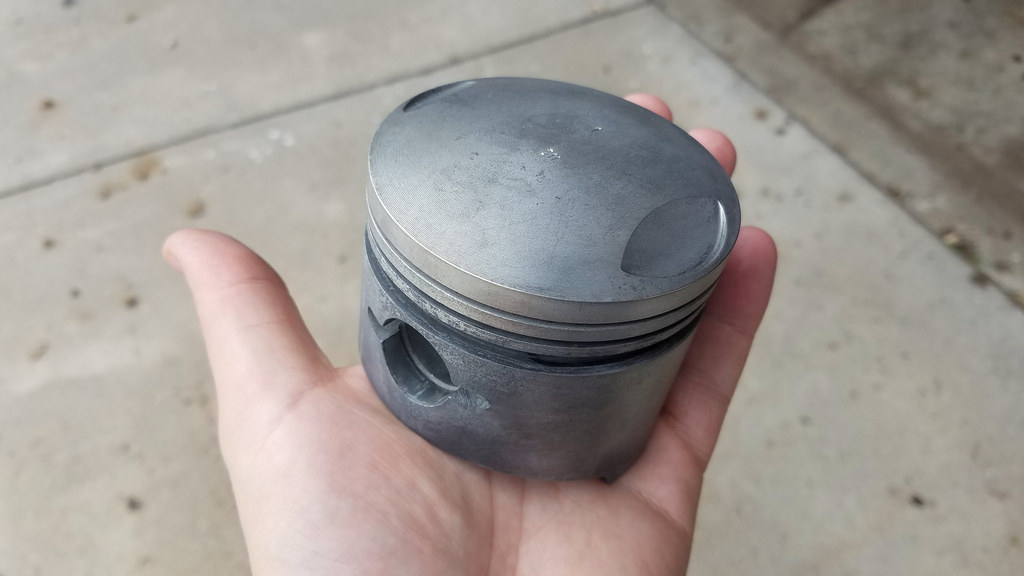

Started cleaning up the pistons and cylinders.
(IMG:http://www.914world.com/bbs2/uploads_offsite/c1.staticflickr.com-19709-1503414559.10.jpg)
Tore down one of the heads, didn't grab any measurements but there's definitely more play in the valve stems/guides than I'd like. I assumed I would be doing valve guides and everything that goes with it but inside I secretly hoped that they'd all be tight and perfect.
(IMG:http://www.914world.com/bbs2/uploads_offsite/c1.staticflickr.com-19709-1503414560.11.jpg)
