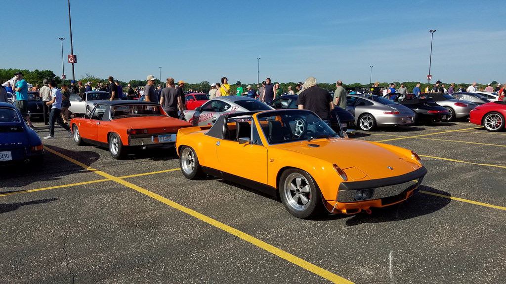

It's first real public appearance was at the June C&C that I attended with a good friend in his 911.
(IMG:http://www.914world.com/bbs2/uploads_offsite/c1.staticflickr.com-19709-1497540075.2.jpg)
Exiting a cloverleaf he pulled away like I was standing still. To add insult to injury a minivan pulled away too. This lit a little spark, I wanted more power. I started crunching numbers for building the type 4, goal is around 150hp. Can you get 150hp in a type 4 that's home built? Sure, lots of people have done it. But there's an even better, more expensive and headache inducing option...
