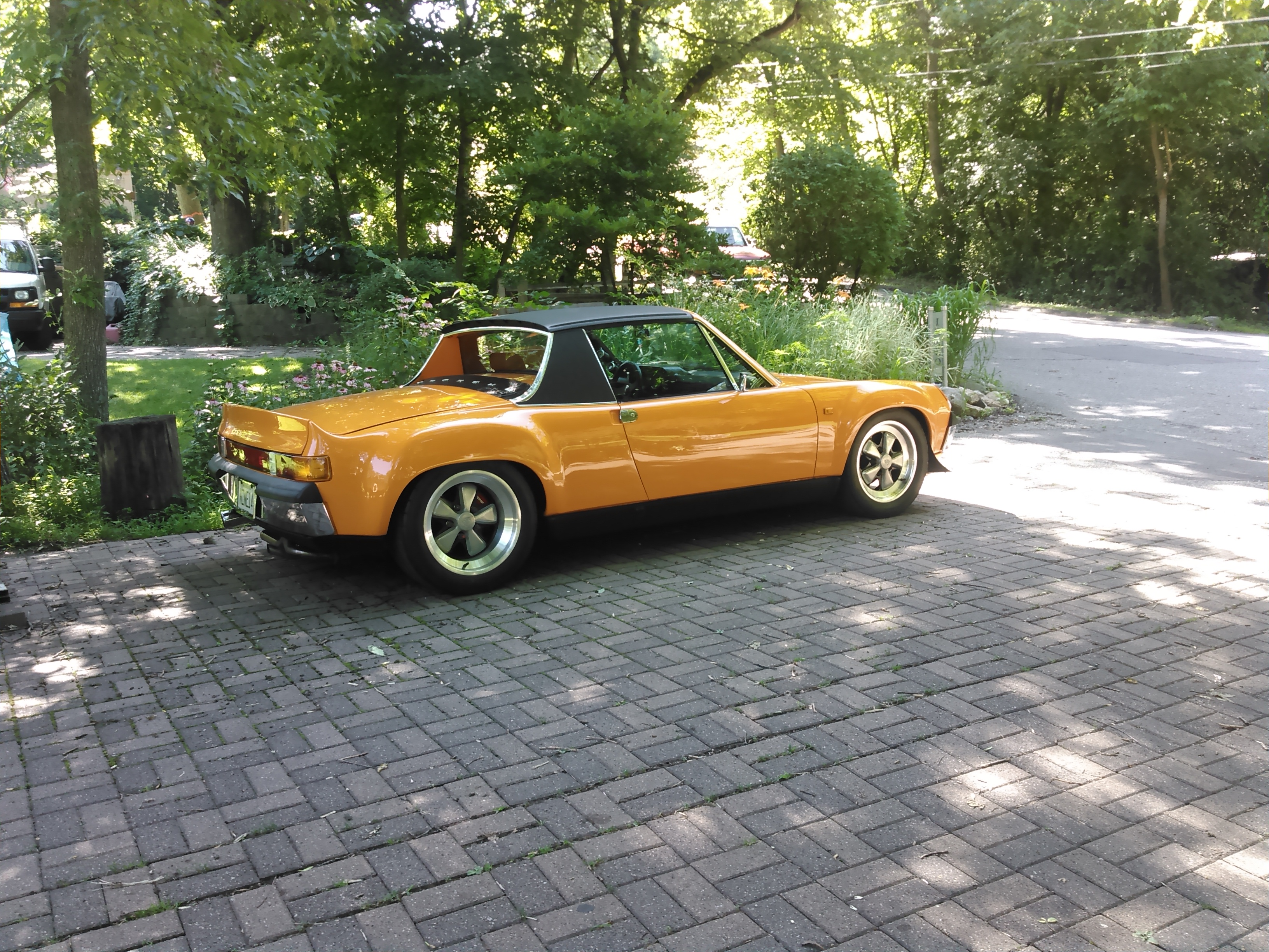

I have Euro blinkers on mine

QUOTE(iamchappy @ Aug 22 2017, 03:09 PM) *
Those are cool. (IMG:style_emoticons/default/thumb3d.gif) I looked at some variations on that theme and if I had a wide body, it would be a no-brainer. I'm hoping to avoid putting new holes in the body though. Push comes to shove, I could re-drill the original side marker holes without have to repaint. No question those markers are way better than the stock issue, and to me, they period-correct too. If Porsche had only done that, I doubt we'd ever have this wart debate.
