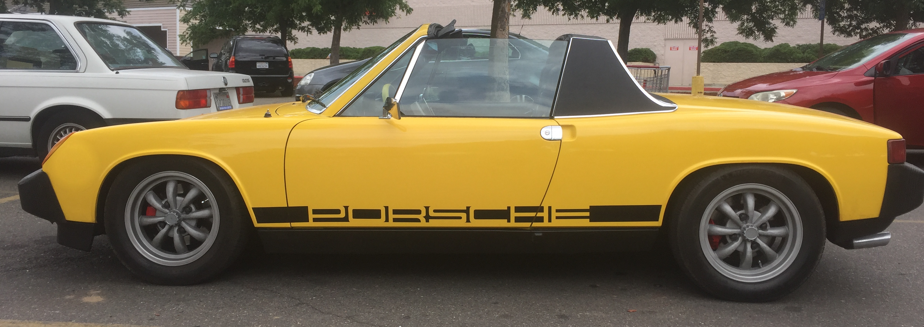

Took a 71 rust and accident free appearance group 1.7 and wanted it to be a sleeper with the following mods:
Conversion to 3.0 carbed 6
Front oil cooler
Full Elephant polybronze suspension
Widened rear fenders to accommodate 7" Fuchs
Full 5 lug conversion
911S front calipers
Euro front and rear turn signals
H4 100/80 relayed lights
Quad gauge
Hidden Engine cut-off switch
Solenoid operated trunk release with emergency manual release
Later model backpad
Vintage Seats Nurburgring driver seat and movable passenger seat
Side shift with bronze bushings
6" and 7" Fuchs
Porsche back panel (blacked out) with remote trunk open
Fogs replaced with driving lights rewired to use as daytime running lights
Tunnel mounted fire extinguisher
LED brake/running and strobing third brake light
Genuine 6 heat exchangers and oil tank
Warts changed from orange to clear to better blend with silver paint.
Console delete
Cup holder added to extinguisher mount
High torque starter
GT style engine grill/s
Fittipaldi stearing wheel
Coco mats
So how does my value now compare to stock with 65K miles?
