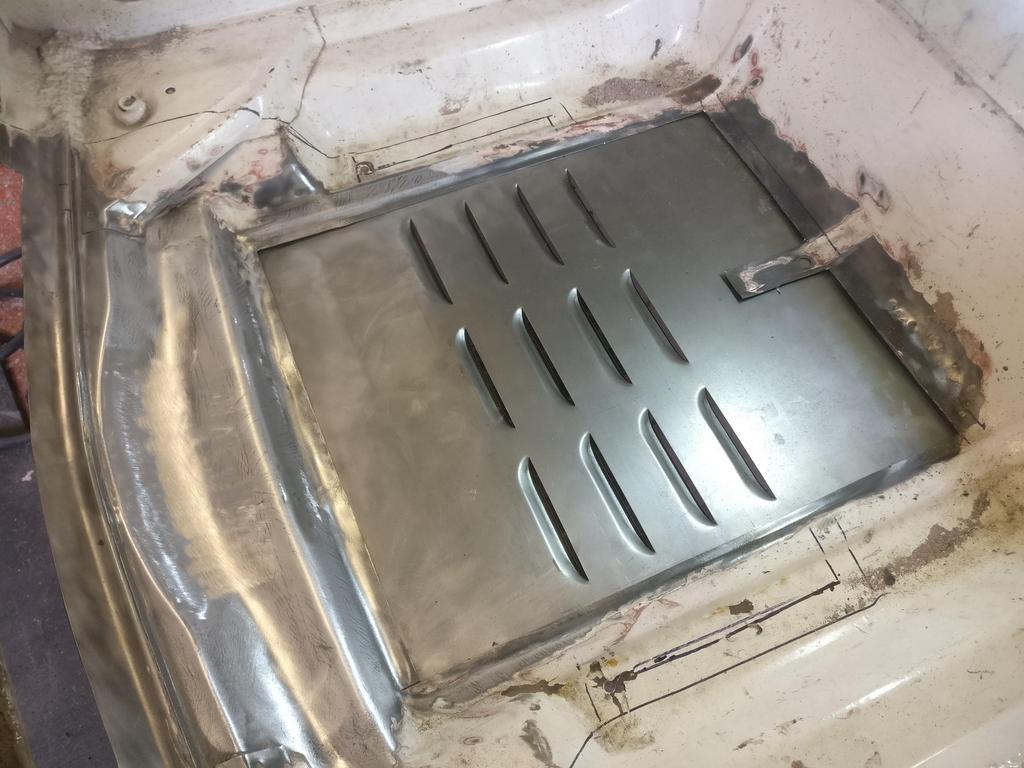

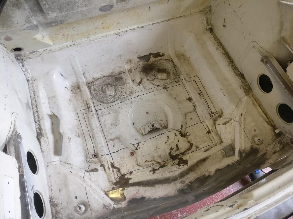

Back to the front of the car to complete the oil cooler installation.
The trouble I went to finding someone to make the louvred panel for me was ridiculous. No one would reply to my enquiries and I end up using a guy that took about a week to reply to each email. Soooooooo frustrating! Even more frustrating was after stumbling across a time-warp metal merchant locally earlier this week, that whilst lovely old boy there hobbled off to cut some sheet to size I find myself staring at a sign - 'Louvred panels made to order' (IMG:style_emoticons/default/laugh.gif) (IMG:style_emoticons/default/laugh.gif)
Anyway, here's my original front trunk floor looking rather shabby, a previous owner had mounted a kerb or similar and made a bit of a mess. This was the perfect opportunity to rectify that.
(IMG:http://www.914world.com/bbs2/uploads_offsite/s6.postimg.org-6621-1503731107.1.jpg)
Most of the damage repaired and offering up louvred panel.
(IMG:http://www.914world.com/bbs2/uploads_offsite/s6.postimg.org-6621-1503731108.2.jpg)

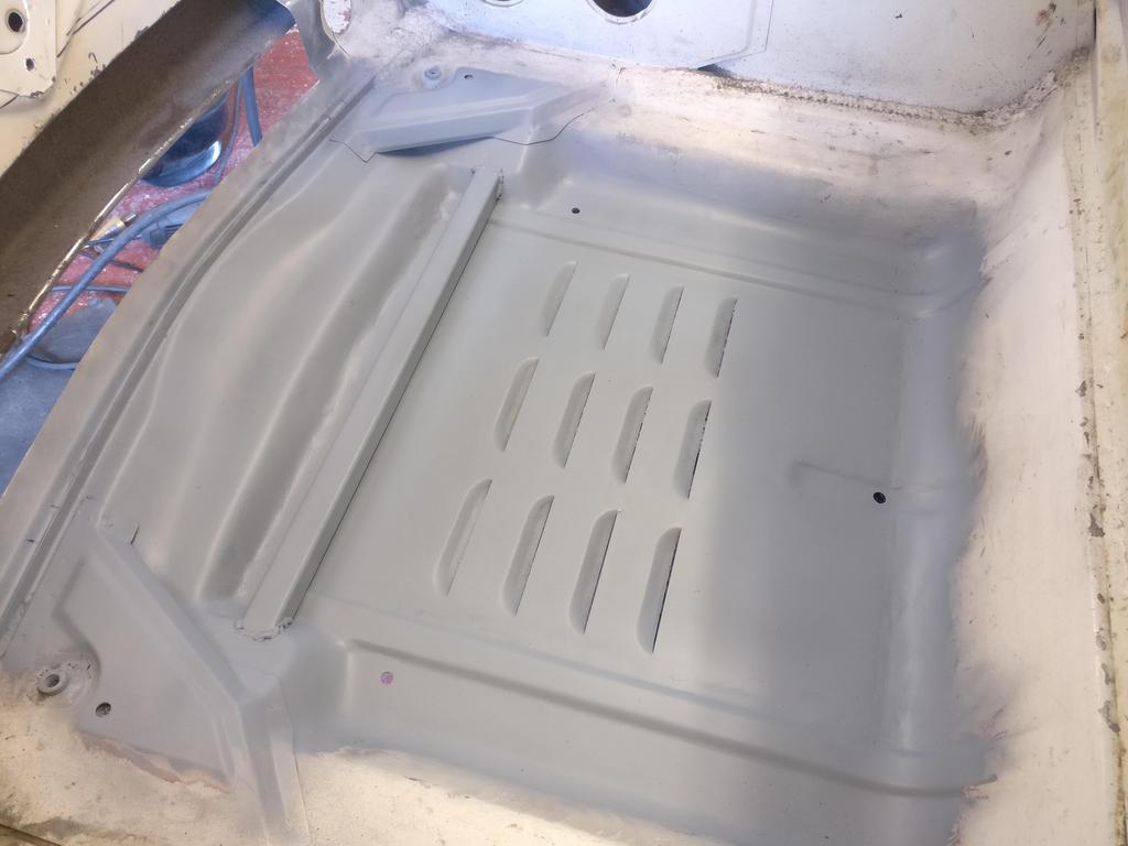

Lots and welding, grinding and swearing later! Ta da!
(IMG:http://www.914world.com/bbs2/uploads_offsite/s6.postimg.org-6621-1503731108.3.jpg)
I can now finish off the front grill I made and get everything dry fitted.
