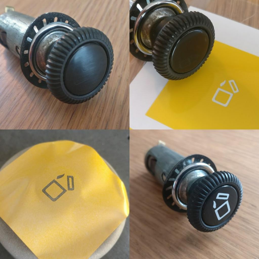

I'm starting to obsess over detail (IMG:style_emoticons/default/laugh.gif) but in my opinion that's what makes a good car.
I was planning a car free day today as we have family over shortly. But, being able to draw and having a vinyl cutter made this very easy and start to finish took less than an hour.
It'll look smart next to the new fuel gauge (IMG:style_emoticons/default/biggrin.gif)
(IMG:http://www.914world.com/bbs2/uploads_offsite/s6.postimg.org-6621-1503845026.1.jpg)
