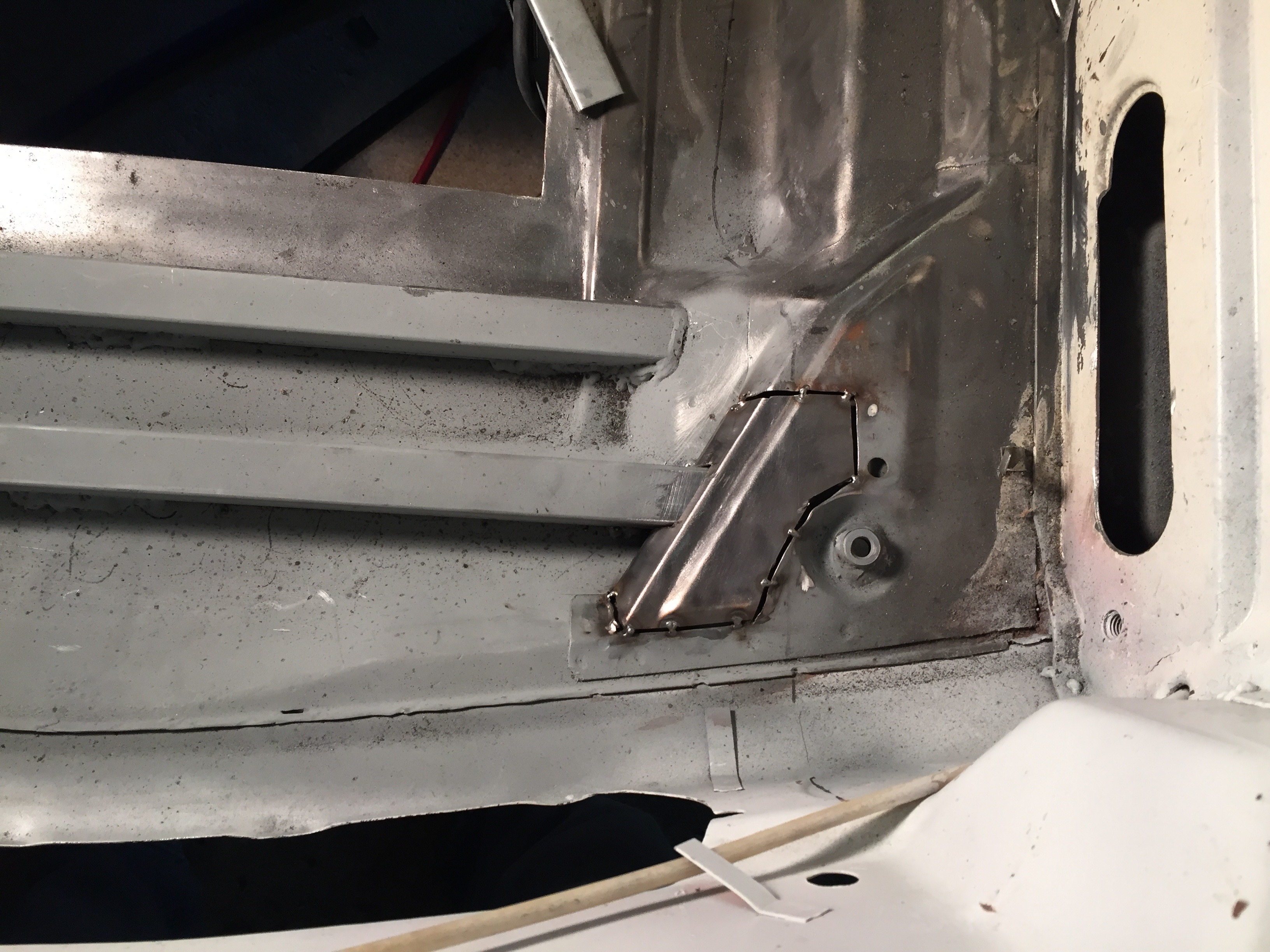

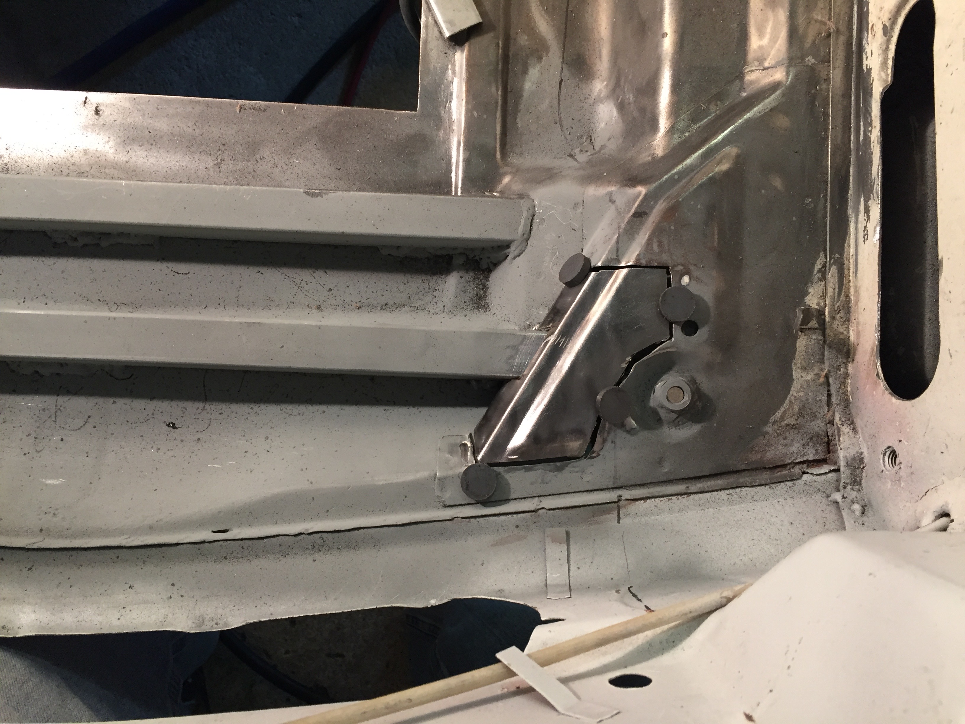

I've completed the reinforcements and welded the cut outs back; here's a few pics

Mitox   I've completed the reinforcements and welded t...   Sep 3 2017, 07:07 PM
Mitox   Completed this section of the project, so tomorrow...   Sep 3 2017, 07:10 PM
