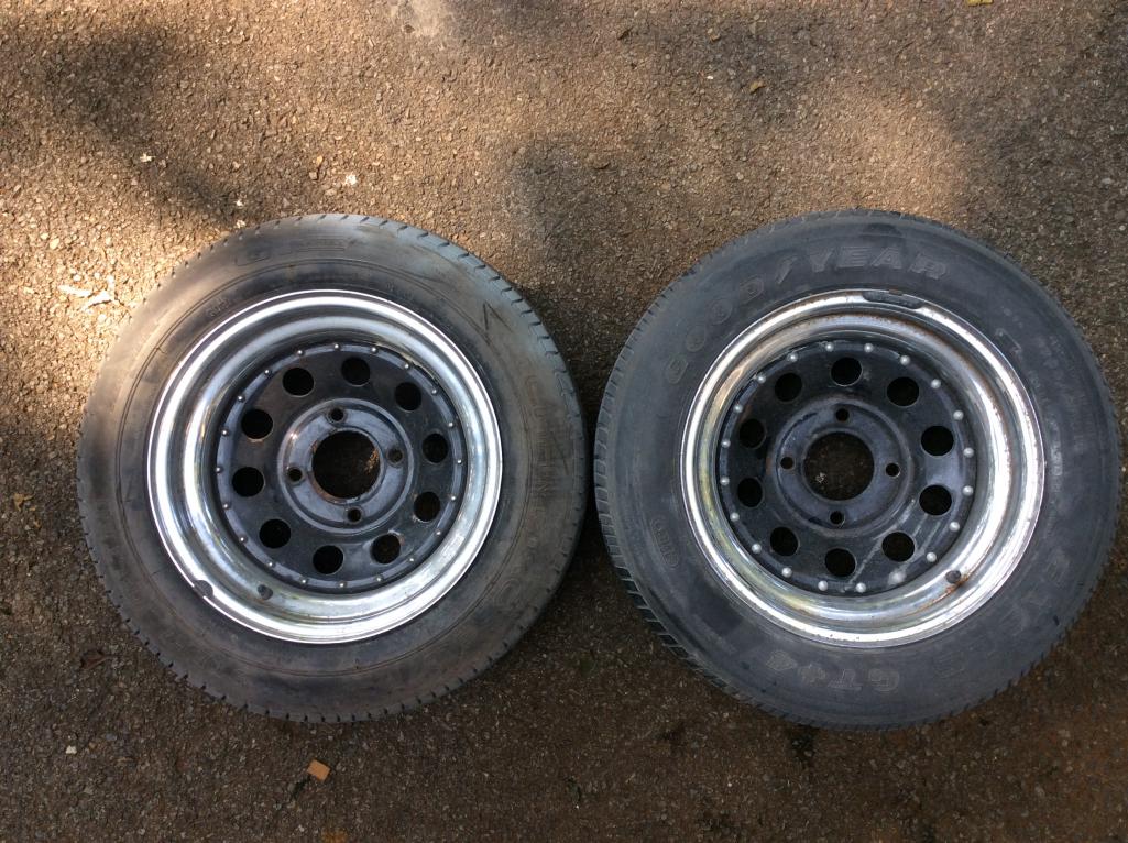

Cleaniing the garage this morning, and need to make space. I'm thinking about trashing the old four lug wheels. I have all four.
Anyone need them? I'm in SW Virginia in Marion.
