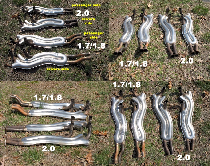

Quick tutorial on different versions of stock exhaust, courtesy of Jeff Bowlsby's 914 Tech Notebook web page (http://bowlsby.net/914/Classic/TechNotebook.htm)

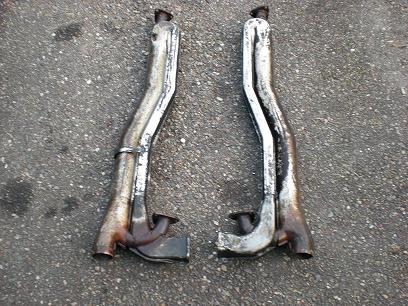

The two 70-74 heat exchanger styles: (IMG:http://www.914world.com/bbs2/uploads_offsite/bowlsby.net-121-1504675264.1.jpg) Here is a picture of the 75-76 heat exchanger: (IMG:http://www.914world.com/bbs2/uploads/post-5678-1233594136.jpg) --DD |
