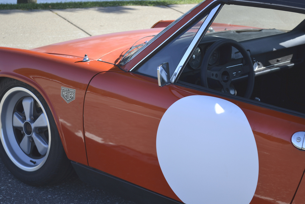

Anyway, the result is good. It's running and driving, the 1911 is strong and runs well. Handles great considering there are no sway bars. Tail shifter is as vague as you imagine though, and the engine is still sub 100hp so it's not incredibly fast.
(IMG:http://www.914world.com/bbs2/uploads_offsite/c1.staticflickr.com-19709-1496565572.1.jpg)

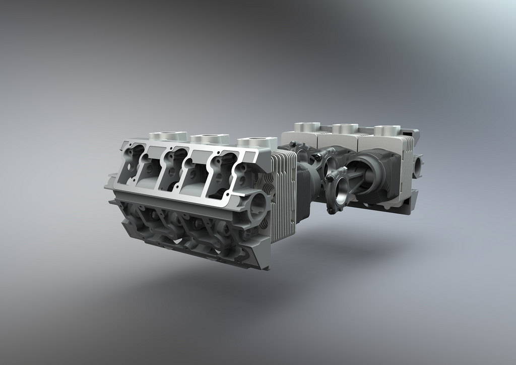

I've been collecting parts, i.e. all the bearings, new rod bolts, gaskets/o-rings/etc. No real work has been done on the engine otherwise.
Also been 3D modelling the engine, but I have a different thread for that.
http://www.914world.com/bbs2/index.php?sho...=315481&hl=
