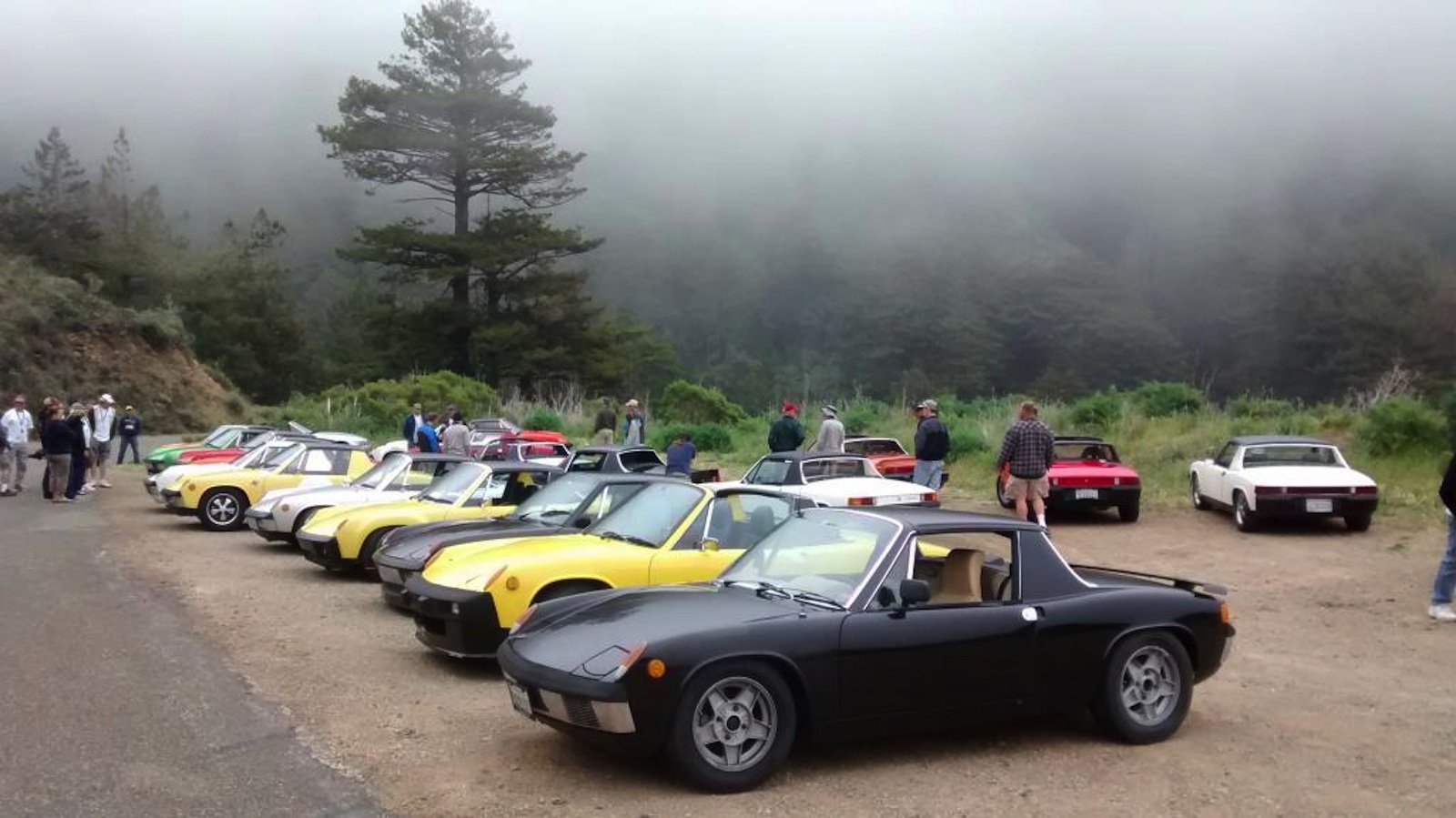

I run with 195/65-15s on the 'BB' (2.1L) ...
I have a set of Pirelli P-6000 185/70-15s earmarked for the '71 (1.9L)
