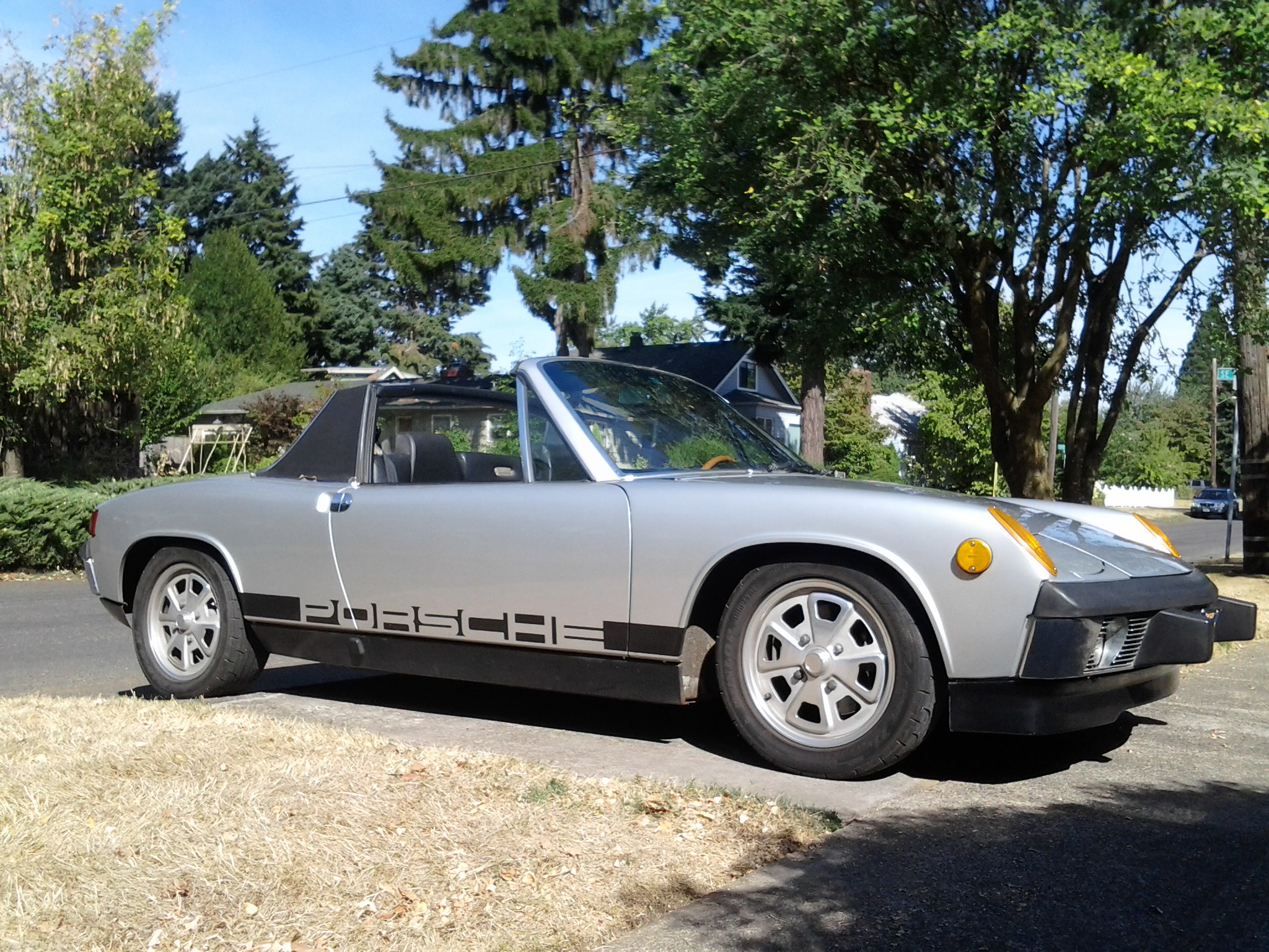

steuspeed
post Sep 14 2017, 02:38 PM
Posts: 1,011
Joined: 12-July 11
From: Portland, Oregon
Member No.: 13,308
Here is how the 195-55-15s look on a stock set-up. Just installed the LE spoiler from 914rubber too. There is enough clearance to get in and out of my driveway.
