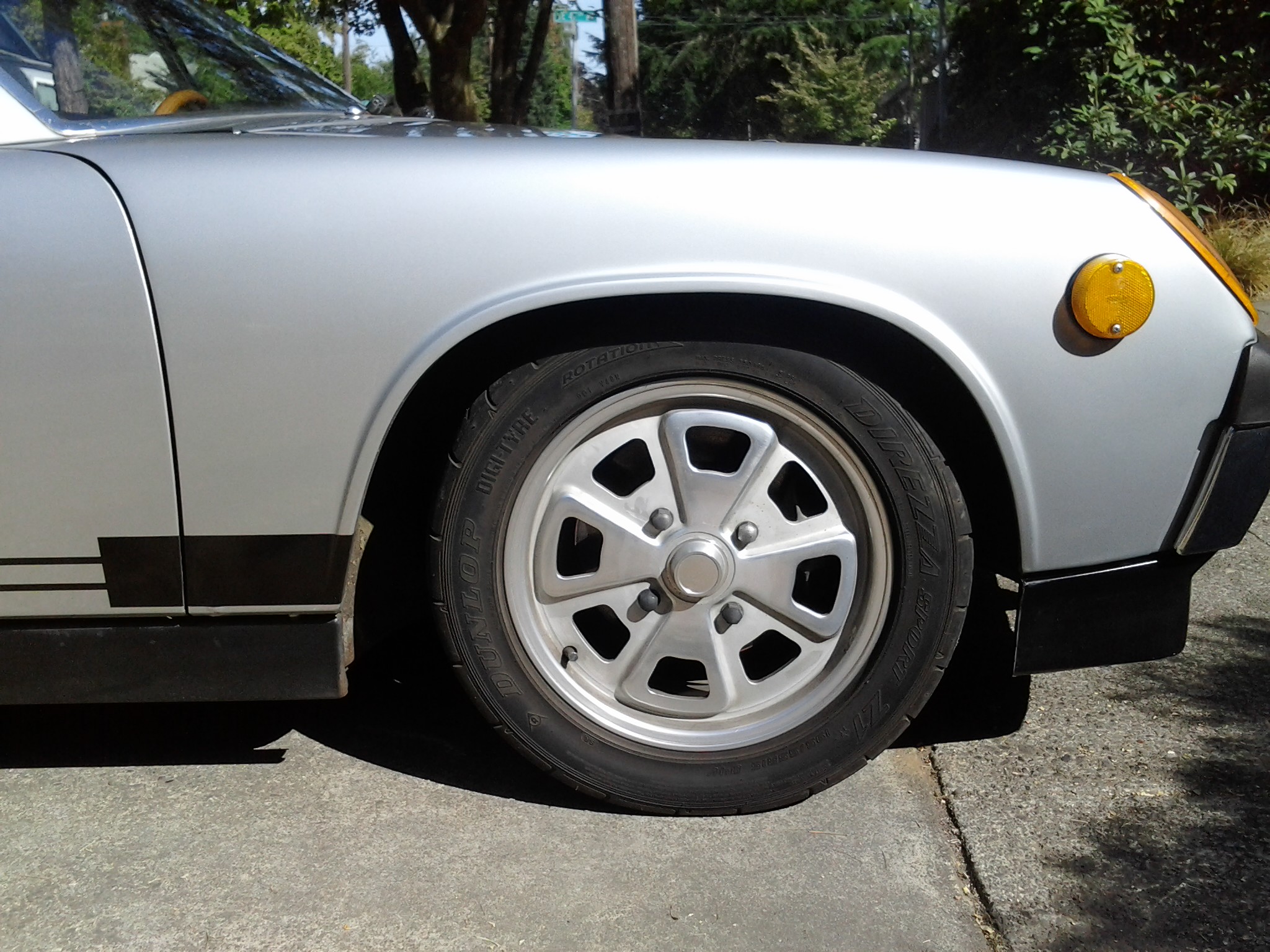

steuspeed
post Sep 14 2017, 02:38 PM
Posts: 1,011
Joined: 12-July 11
From: Portland, Oregon
Member No.: 13,308
Here is how the 195-55-15s look on a stock set-up. Just installed the LE spoiler from 914rubber too. There is enough clearance to get in and out of my driveway.
Robnxious
post Sep 14 2017, 03:54 PM
RobnxiousOne
Posts: 184
Joined: 26-October 06
From: Sacramento
Member No.: 7,097
QUOTE(steuspeed @ Sep 14 2017, 01:38 PM) *
Those look sweet. That is what I was thinking of with mine. Larmo's look nice too, and show me what I can do w/ a different rim on them
