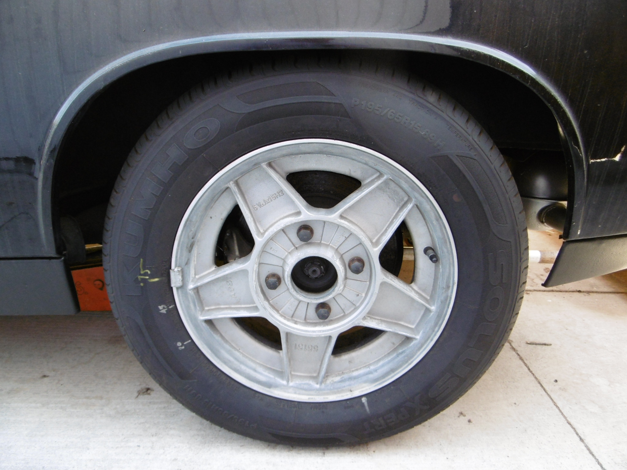

Philip W.   ive run 4 diifferent rims and tire set ups on my c...   Sep 11 2017, 08:41 AM
Philip W.   current look front   Sep 11 2017, 08:50 AM
