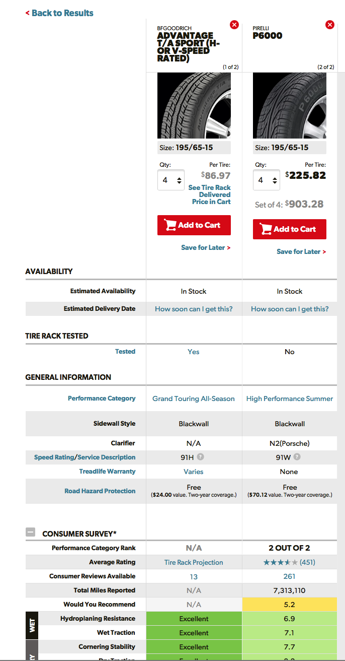

Even so, I like 195/65 and 205/60, and there are a couple of interesting choices in both categories. Remember that nearly any tire of today is a faaaaaar better tire than anything the 914 came equipped with.

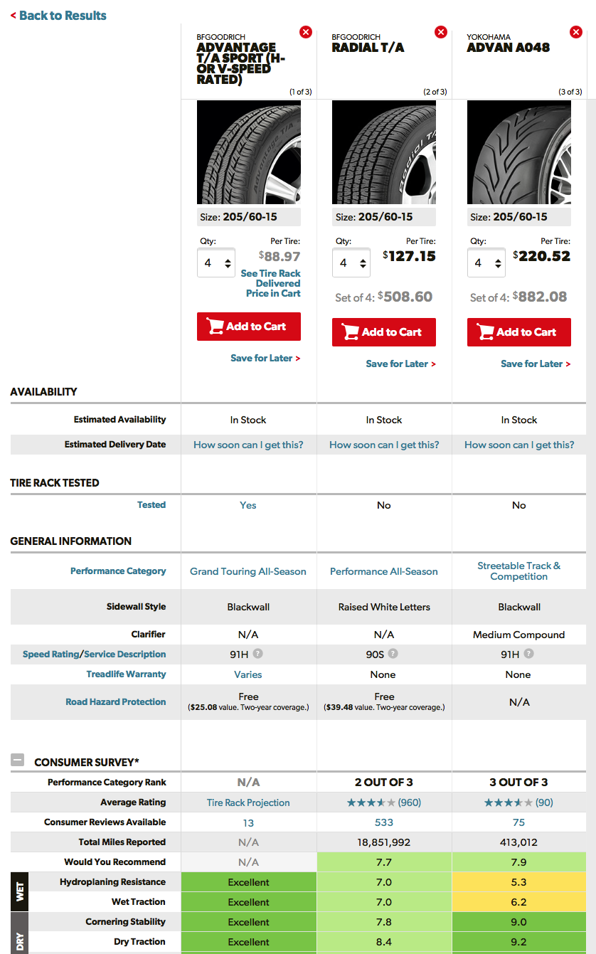

The Pirelli is N-spec (Porsche approved) and is probably the only summer performance tire available in one of these sizes. Looks great on the cars, with nice sidewall bulge and it is sure to fit the wheel wells on most 914s. The Yokohama is a great autocross tire (there are almost certainly better ones) with a great, simple sidewall but a pretty alien tread pattern. The BFG Comp T/A has long had me wondering about how it works on a 914, as the look is period right on a 914 so long as the white letters are faced in to hide them. As seen on the recent super clean 914-6 GT tribute that sold on BaT for $55k....
