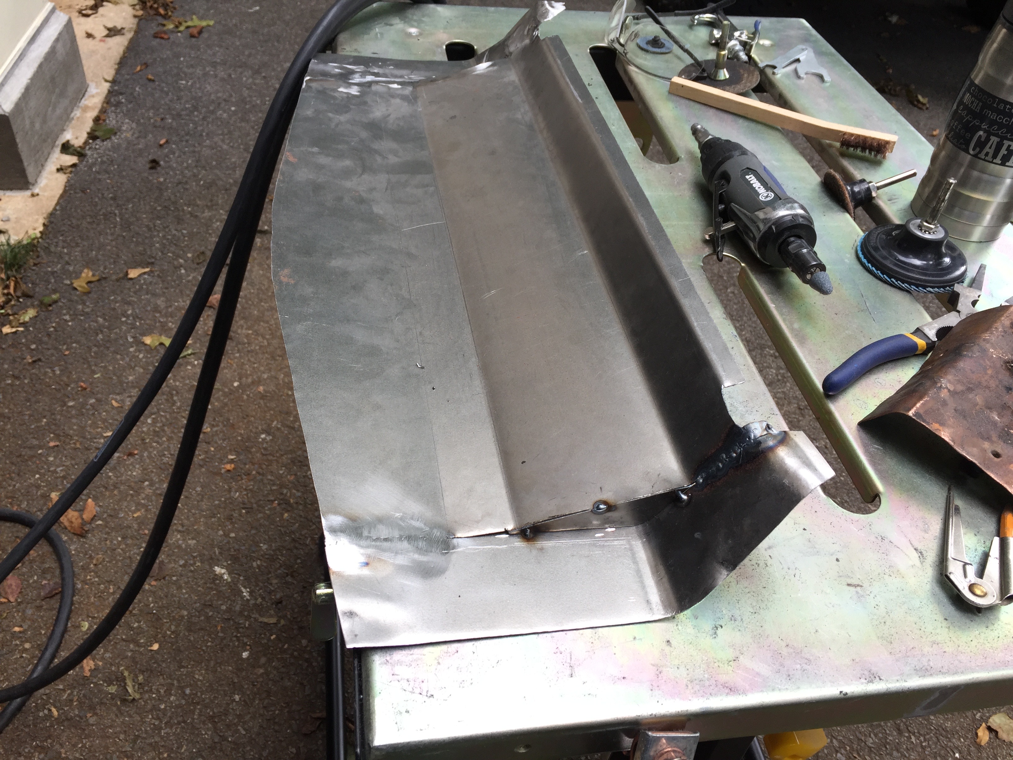

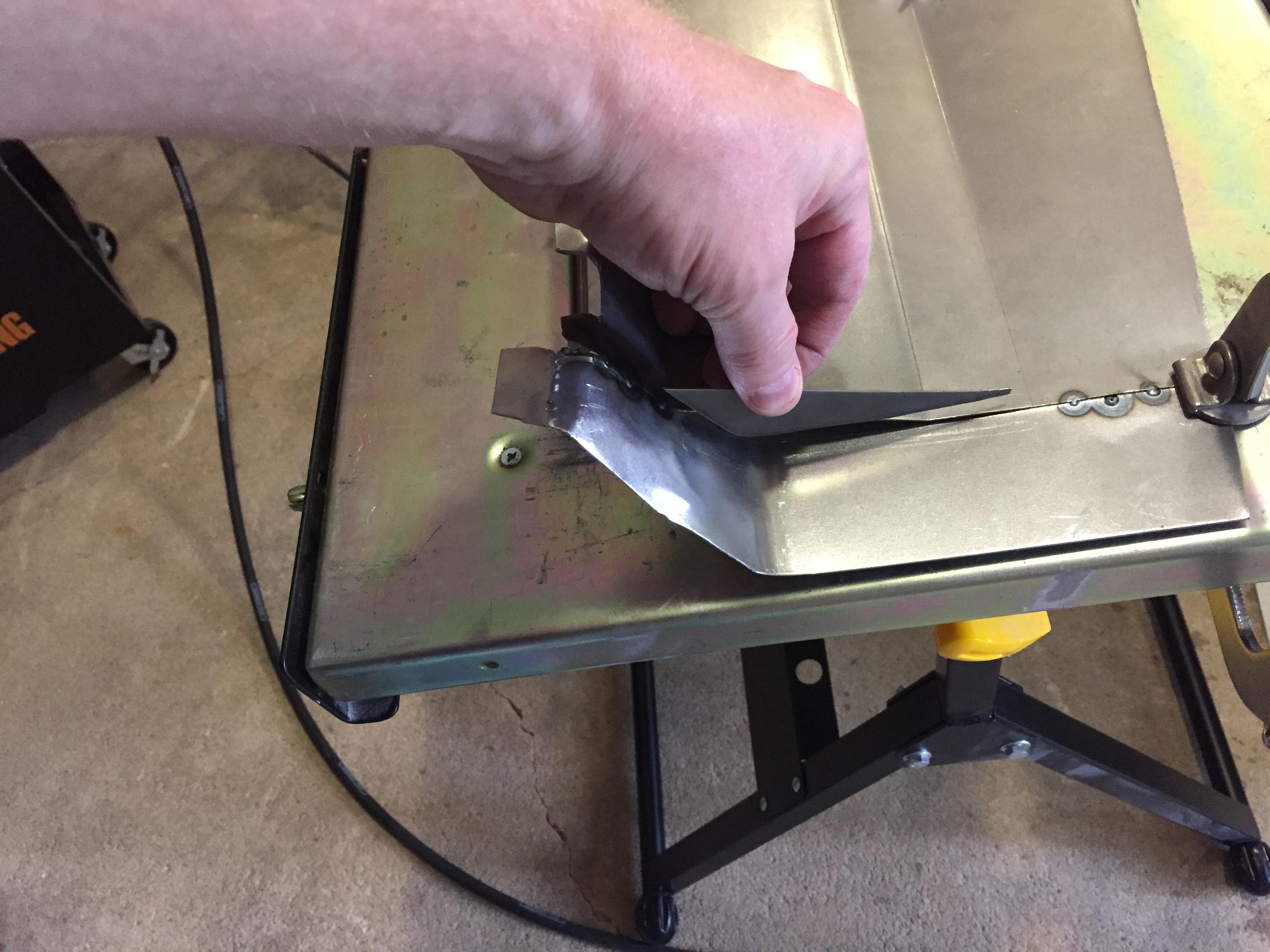

Mitox   Getting close to finishing the oil cooler mod. Ma...   Sep 8 2017, 08:55 PM
Mitox   The bottom section of the oil cooler shroud is nea...   Sep 20 2017, 09:06 PM
Mitox   Few more pics   Sep 20 2017, 09:09 PM
Mitox   Finished pic (almost)   Sep 20 2017, 09:11 PM
