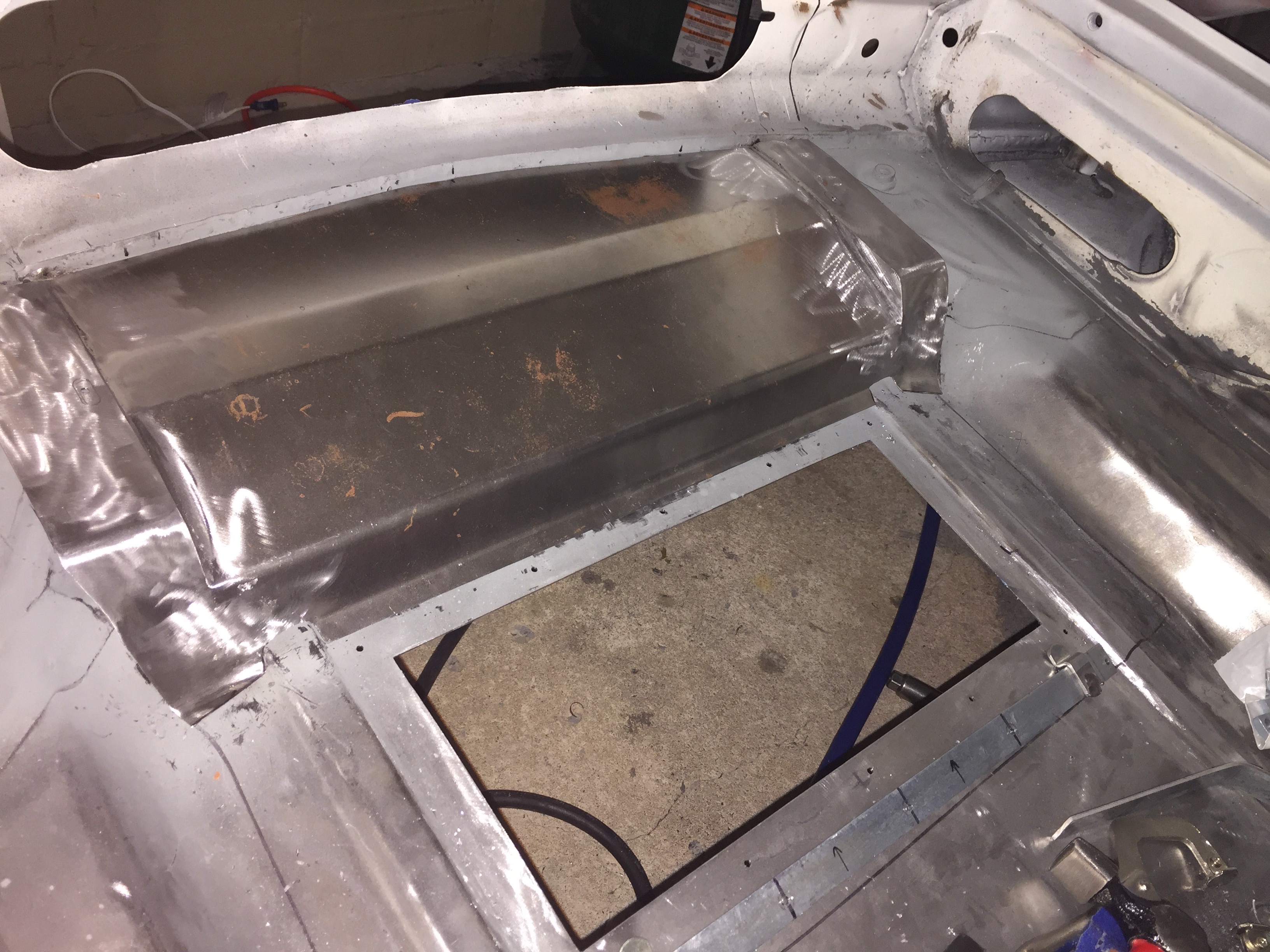

Mitox   I completed the front trunk floor welding last wee...   Aug 6 2017, 09:03 PM
Mitox   Here the almost finished shot. Needs minor smooth...   Aug 6 2017, 09:09 PM
