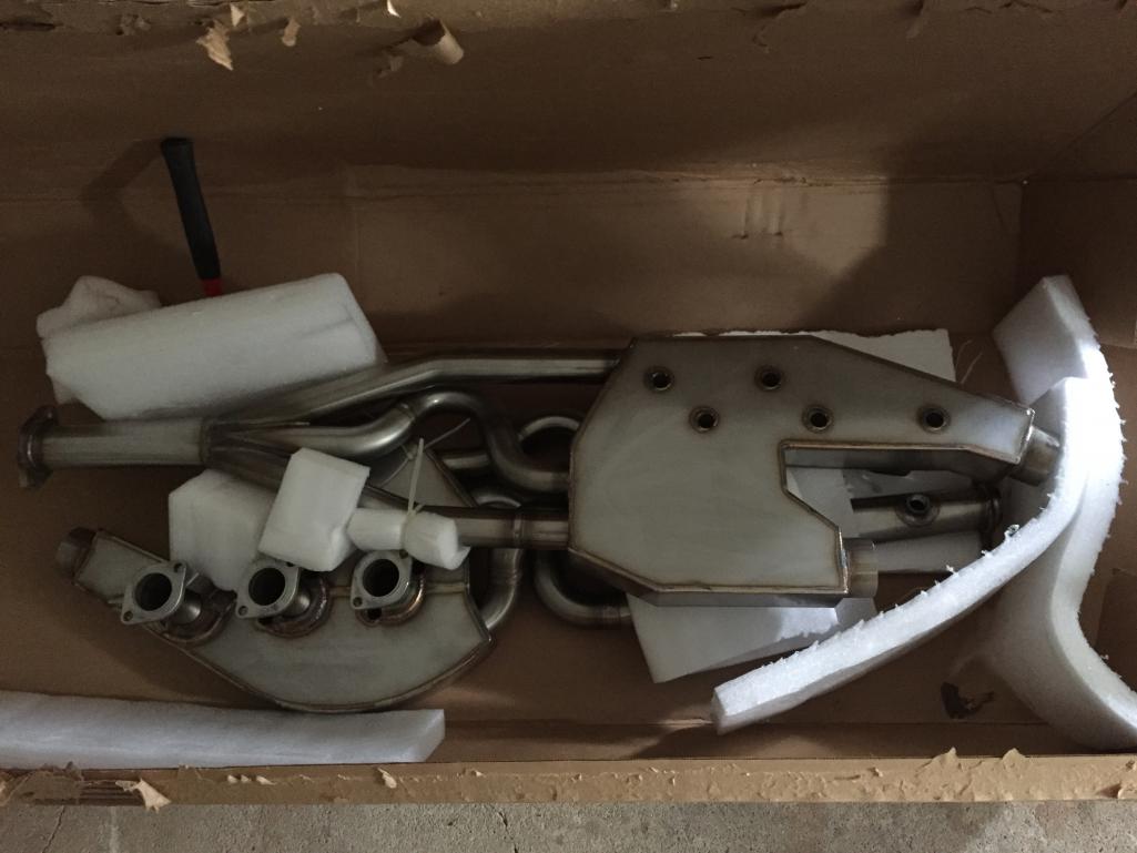

WOW!! These pipes are beautiful. (IMG:style_emoticons/default/biggrin.gif)
I first noticed the welding quality; Ben is truly a master. (IMG:style_emoticons/default/pray.gif)

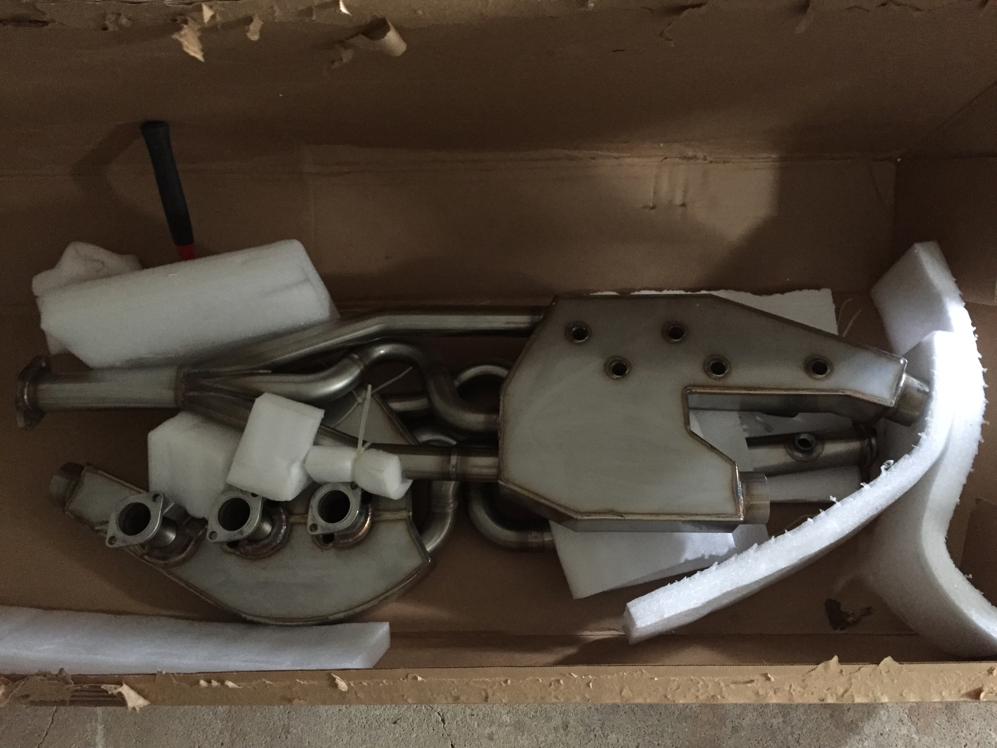

Mitox   WOW!! These pipes are beautiful. :D I ...   Sep 25 2017, 03:49 PM
mb911   Lots of practice :D   Sep 25 2017, 04:49 PM
