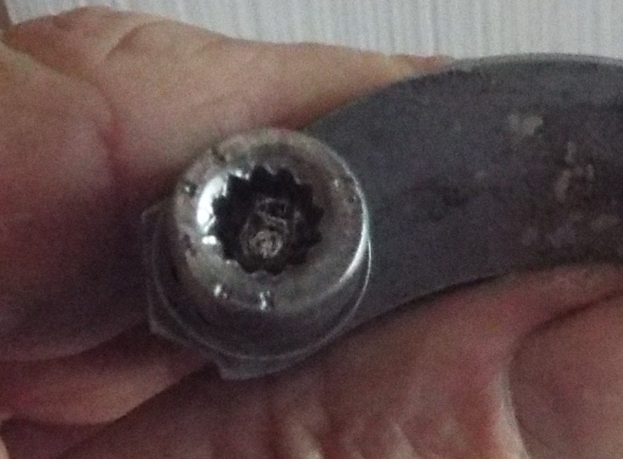

Lucky9146
post Sep 26 2017, 03:27 PM
Posts: 1,711
Joined: 22-September 14
From: Poway California
Member No.: 17,942
QUOTE(Perry Kiehl @ Sep 24 2017, 01:18 PM) *
Stock 914 4 and 6 CV bolts are 12 point triple square allen, so you need to clean them off and get a close look. If you use a 6 point allen you'll strip them.
I clean them really good and tap them in the socket before leaning on them. If you don't seat it in the socket, you can strip it.
This is what came with mine. Trans was out so assuming these are correct?
