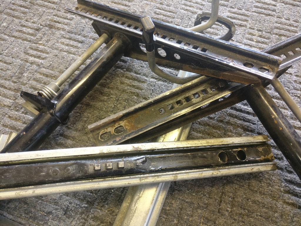

I've been doing the seat rails for months, seemed like a lot of work for yet another something no one ever sees, but they certainly needed some TLC.
Worse condition than I remembered.

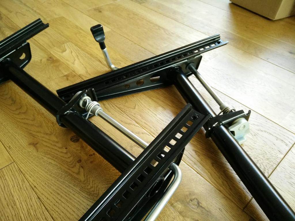

Stripped down, frame blasted and painted. Bright parts replated.
(IMG:http://www.914world.com/bbs2/uploads_offsite/s6.postimg.org-6621-1506873984.2.jpg)
Refitting those springs were a bit of a nightmare but I finally came up with a solution after bending a couple of screwdrivers (IMG:style_emoticons/default/laugh.gif)
