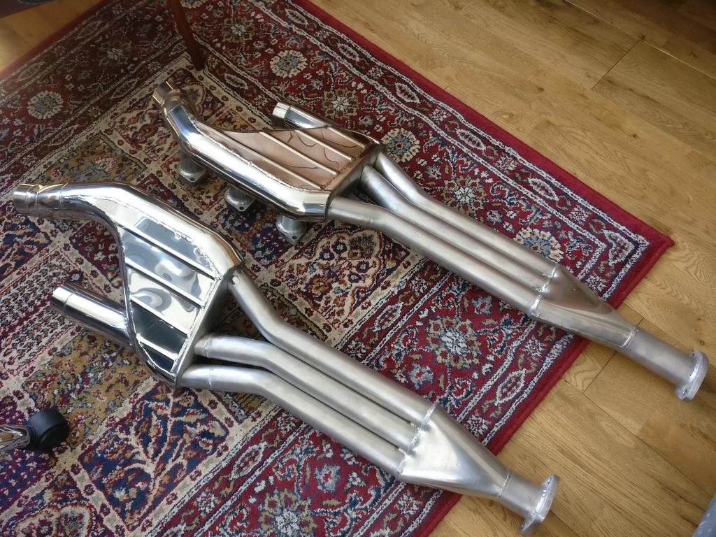

New custom made Hayward & Scott heat exchangers arrived. Such a shame they're going to be hidden away under the car.
Hayward & Scott are fairly local to me and were really good. I called them a few months ago to discuss what I was after. They mention they had just finished a couple of sets for a US customer and I was more than welcome to pop in to take a closer look. During my visit I placed an order.
(IMG:http://www.914world.com/bbs2/uploads_offsite/s6.postimg.org-6621-1506874002.1.jpg)
(IMG:http://www.914world.com/bbs2/uploads_offsite/s6.postimg.org-6621-1506874002.2.jpg)
