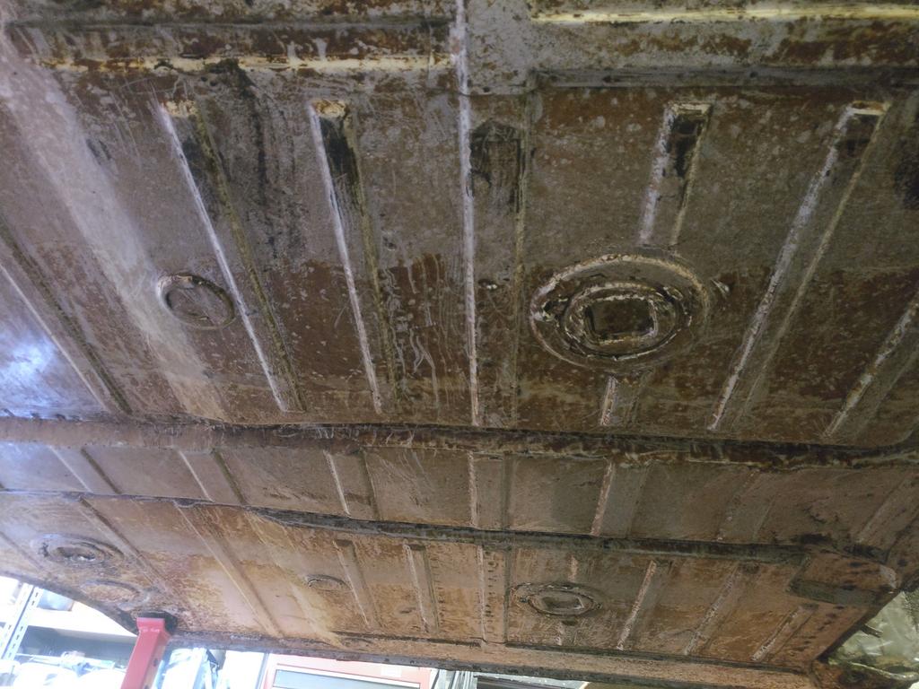

So with almost everything else completed and stuffed into every nook and cranny in the house it was time to get back to bodywork.
About the only part really left unexplored was the underneath of the floor. The top was almost perfect so I was hoping the underside was in a similar condition.
Looks promising!
(IMG:http://www.914world.com/bbs2/uploads_offsite/s6.postimg.org-6621-1506874043.1.jpg)

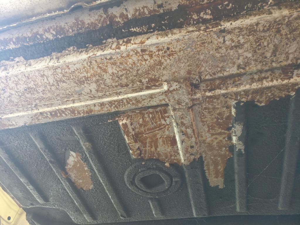

The brown parts are just underseal residue. The floor is again almost perfect - 99% original paint and just a tiny bit of very light surface rust.
(IMG:http://www.914world.com/bbs2/uploads_offsite/s6.postimg.org-6621-1506874043.2.jpg)
