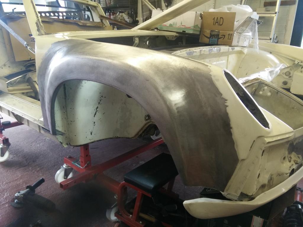

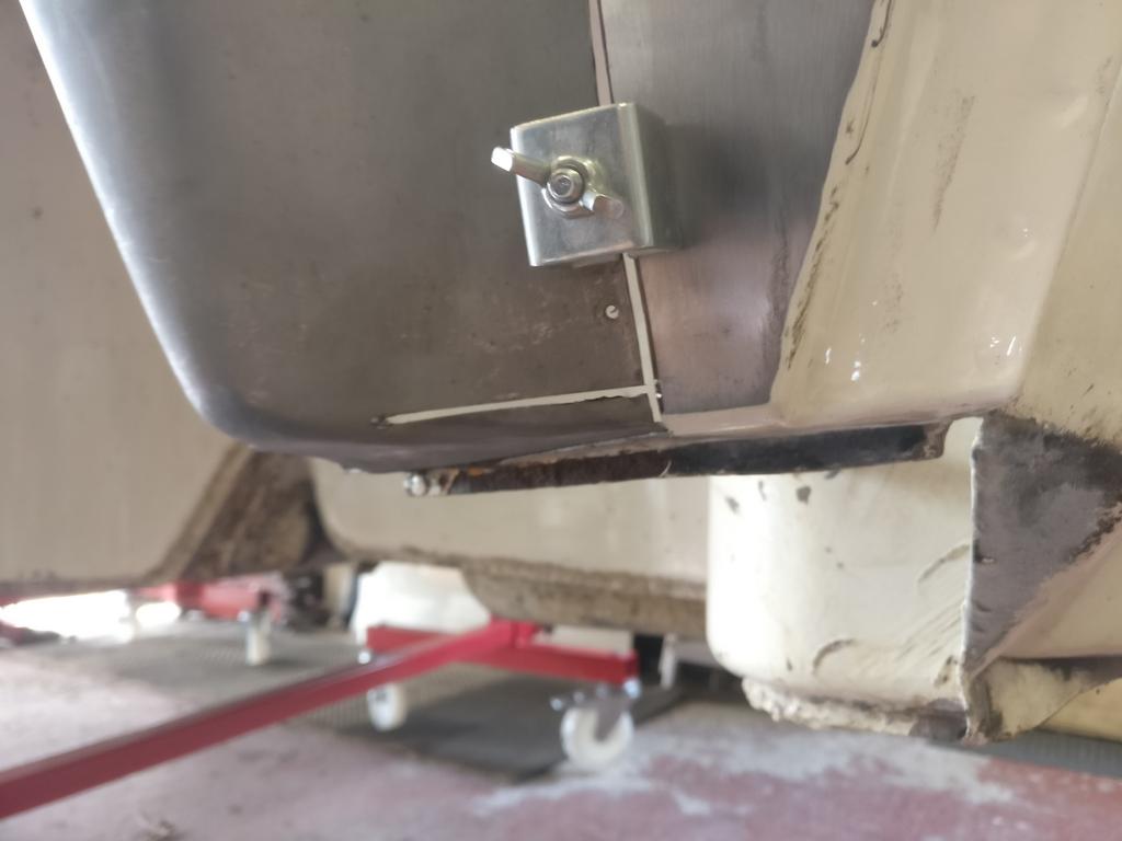

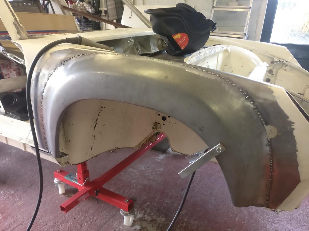

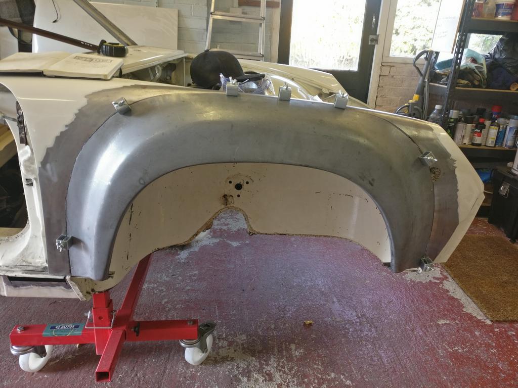

Over the past few months various small projects have given me the opportunity to get my welding skills up to scratch for the main event (IMG:style_emoticons/default/laugh.gif) adding the GT flares to the car. With almost nothing left on the car to restore now was the time.
I had the chance to follow James 23e Heure's build. When his arches were installed they saved the off cuts for me. This enabled me to cut them up and practice welding them back together. My first attempts weren't great but I was going to do this and my perseverance was finally rewarded.
It took a lot of confidence just to do this!
(IMG:http://www.914world.com/bbs2/uploads_offsite/s6.postimg.org-6621-1506874062.1.jpg)

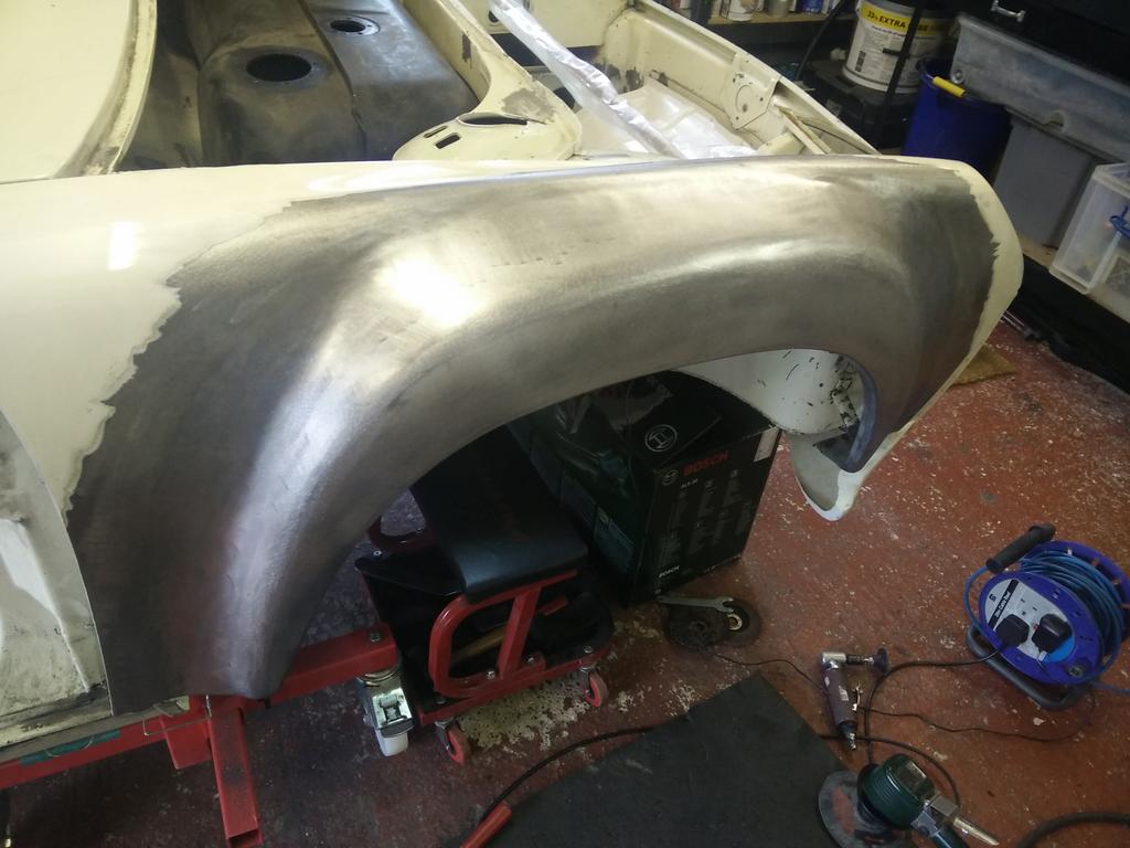

Initial fitting
(IMG:http://www.914world.com/bbs2/uploads_offsite/s6.postimg.org-6621-1506874063.2.jpg)

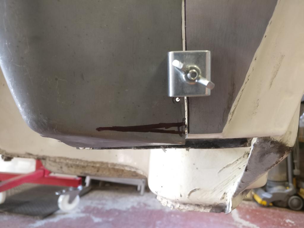

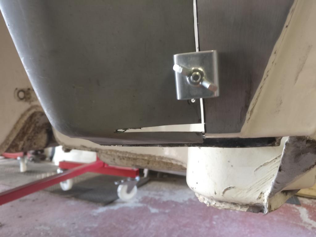

It's common knowledge that the bottom of AA flares don't have the same profile as the wings on the car so a bit of fetling it required.
(IMG:http://www.914world.com/bbs2/uploads_offsite/s6.postimg.org-6621-1506874063.3.jpg)
(IMG:http://www.914world.com/bbs2/uploads_offsite/s6.postimg.org-6621-1506874063.4.jpg)
(IMG:http://www.914world.com/bbs2/uploads_offsite/s6.postimg.org-6621-1506874064.5.jpg)

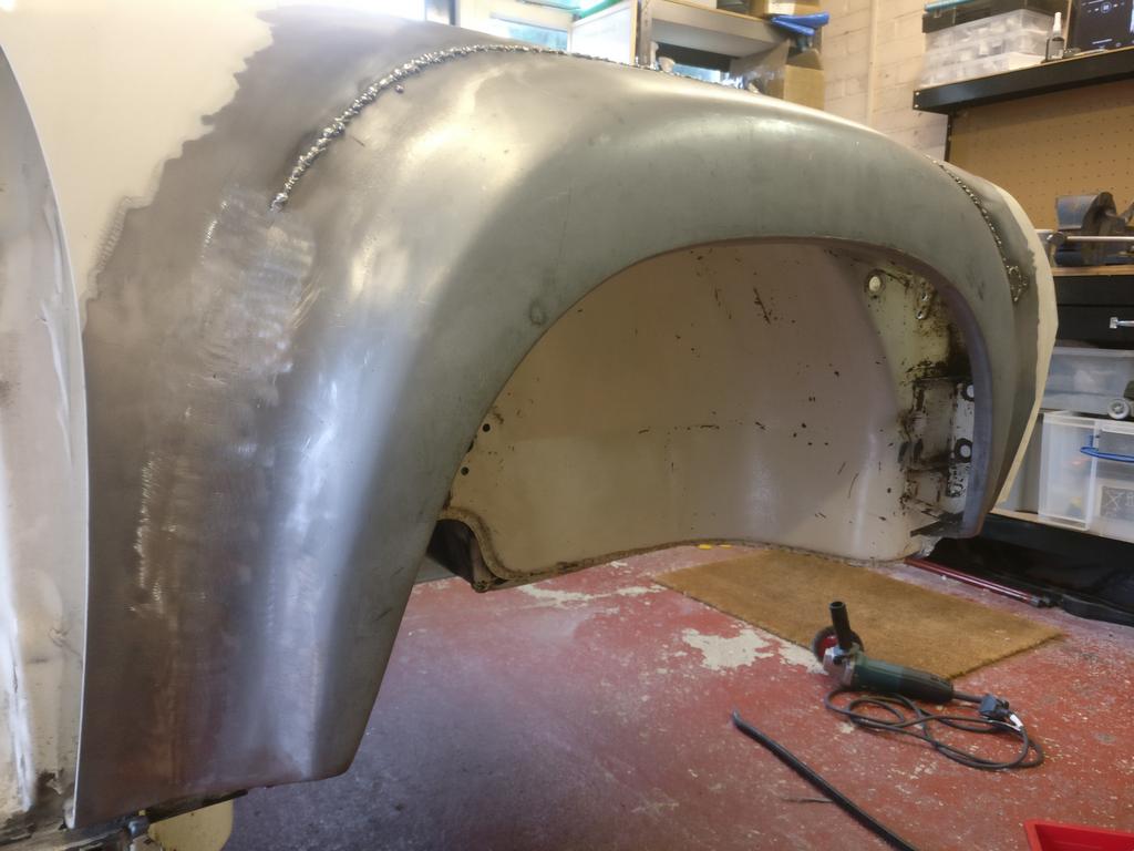

Slowly...
(IMG:http://www.914world.com/bbs2/uploads_offsite/s6.postimg.org-6621-1506874064.6.jpg)
(IMG:http://www.914world.com/bbs2/uploads_offsite/s6.postimg.org-6621-1506874064.7.jpg)
Finished
(IMG:http://www.914world.com/bbs2/uploads_offsite/s6.postimg.org-6621-1506874065.8.jpg)
(IMG:http://www.914world.com/bbs2/uploads_offsite/s6.postimg.org-6621-1506874065.9.jpg)
