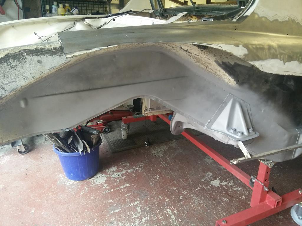

Moving on to the rear
The rear quarter is exposed because of the previous accident damage, I'm in the process of repairing that now but am waiting on repair panels. In the meantime I can intall the GT strengthening kit.
First to prep the area.

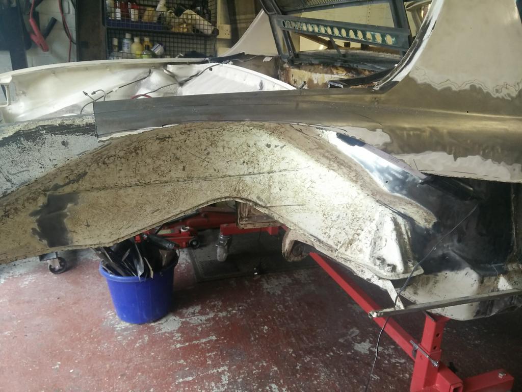

(IMG:http://www.914world.com/bbs2/uploads_offsite/s6.postimg.org-6621-1506874085.1.jpg)
Weld Thru Primer
(IMG:http://www.914world.com/bbs2/uploads_offsite/s6.postimg.org-6621-1506874085.2.jpg)

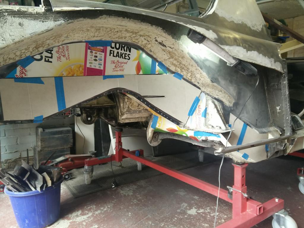

The parts supplied in the kit needed to be bent into shape and I found the needed a bit of trimming too. I made some carboard templates from them and adjusted them to fit before applying those back to the parts and trimming them to fit.
The cardboard GT sstrengthening kit (IMG:style_emoticons/default/laugh.gif)
(IMG:http://www.914world.com/bbs2/uploads_offsite/s6.postimg.org-6621-1506874086.3.jpg)

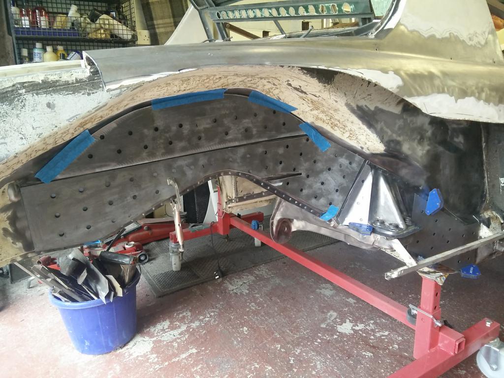

Final Test Fit
(IMG:http://www.914world.com/bbs2/uploads_offsite/s6.postimg.org-6621-1506874086.4.jpg)
That's it, up to date again. I'll be in the garage again tomorrow welding all that in.
